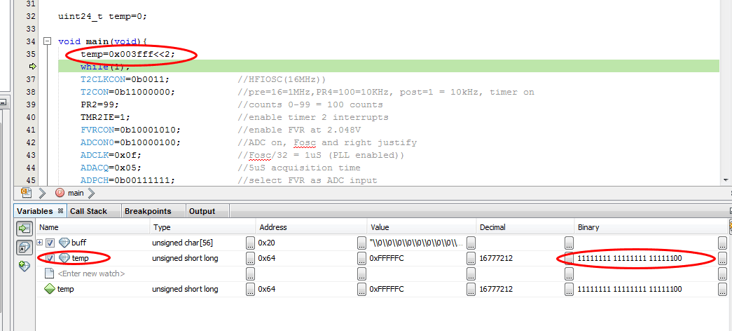

I have a project that uses an uint24_t or unsigned short long (as MPLABX calls it) and I was getting some strange behavior.
I did a simple test to check this with the following code,
I assumed temp would contain 0xfffc but it appears that the upper byte has also been set to 0xff.

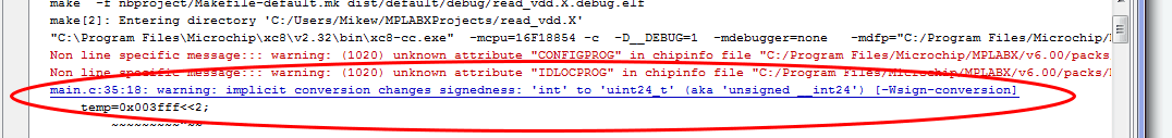

I get this warning which I assume has something to do with it,
But I don't understand this warning.
I can fix the error by using a cast, temp=(uint24_t)0x3fff<<2;
However, I'm trying to understand what is happening. Note the variable is set to zero at startup.
Thanks,
My guess: try prefixing the 2 with 0x
Logic: the immediate value 2 is being stored as a signed int; it's part in the shift is causing the result to be a signed int and a negative value.
When that is assigned to the uint24_t, the sign bit gets extended.
It's not the 2 being not hexadecimal. What I think is happening is the 0x3fff is being shifted left to be 0xfffc and then the sign is being extended into the 24 bit variable. I can fix it in two ways, make the constant long temp=0x3fffL<<2; or cast to uint24 temp=(uint24_t)0x3fff<<2; It was your bit about sign getting extended that made me realise. Thanks,

For the sign to be extended, the result has to be signed. If the 2 isn't the cause, then it suggests that all hardcoded ints are treated as signed regardless of whether expressed in decimal or hex.
In which case the typecast of a hardcoded value to an unsigned int shouldn't cause any code generation; it should just be telling the compiler that is should treat the value as unsigned from the get go.
