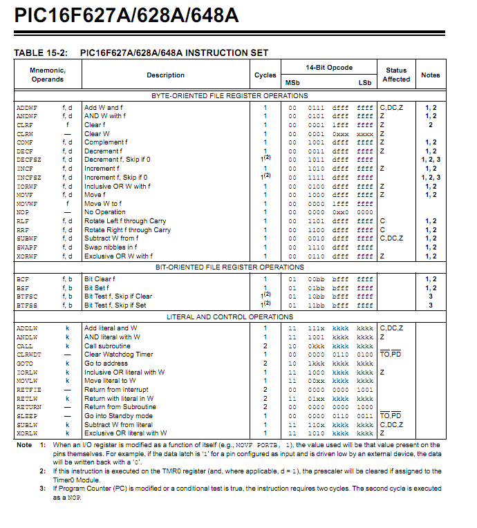

My question goes like this:
Convert the following machine code into an instruction: 0064h
This is my working out so far. I assume we want this in binary since figure 15.2 has the instructions in binary. I have this so far.
0064H
4 x 1 = .4
6 x 16 = .96
Total = .100
.100 in Binary is 0110 0100
What I dont understand is how to convert this binary into an instruction. There are 14 bits, and I have only 8. Bits 13 to 8 is the opcode apparently.
The way I see it is it has to be:
Bit Test f, Skip if Clear
This has the code:
01 10bb bfff ffff
Is this right? Im really not sure about this, and im guessing its probably wrong.

The instruction that assembles to 0x0064 is CLRWDT.

I beleive this is a IORWF which has the following value:
00 0100 DFFF FFFF
This means D = 1 and F= 10 1000 0011
What does this actually mean?
The binary code about is 16, but the Opcode is actually 14. Do I strip off the two MSB's? If that is the case then I think the answer will be BCF
01 0010 1000 0011
B = 101 = 5
F = 000 0011 = 3
I dont understand what these B and F values mean though.

c) 1283h = 01 0010 1000 0011
00 0100 DFFF FFFF
00 0010 1000 0011 is IORWF STATUS, d
01 0010 1000 0011 is BCF STATUS, 05 where bit 05 is the RP0 bit.
Make your mind up which opcode you are examining 0283 or 1283!
Wrong for the OP code first stated 1283h, there is no d bit.
And wrong for the second opcode 0283
D=1 and F= 000 0011 (3 in decimal)
For all PIC instructions, when d=0 the result of the instruction is placed in the W register, and when d=1 the result is put into the register f.
To find which register is "3" look in the register file summary for your PIC, on the sheet I have beside me (16C84, no heckling from the gallery now!), "03" is the STATUS register.
(Just looked at the sheet for a 16F887 and 03 is the STATUS reg there, again, probably the same on all PICs).
Having re-hashed this reply, I think I have given a reasonable answer to a confused question.
Your HEX to binary need to be worked on because it's really simple:
0064H
is 0000 0000 1100 0100
Note that 0000 = 0, 0000 = 0, 1100 = 6h, and 0100 = 4h
So, just expand in groups of 4. It works in reverse too from binary to hex (separate into groups of 4).

Im sorry Jim, I was switching between the two accidently. It should be 1283h. So, with respect to that we have it like this:
01 0010 1000 0011
-- -- BB BFFF FFFF
So we have BBB as 101 (.5), and F as 000 0011 (.3)
Third 03H file register is Status and bit 5 of the status register is RP0. I understand im repeating what you said but it helps me to go through it. Thank you for helping me to clear it up.
