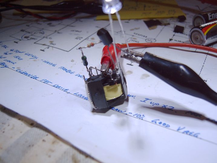

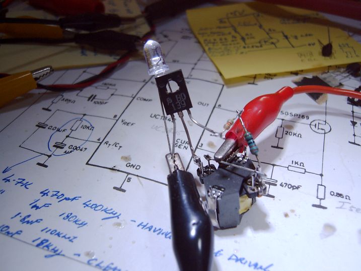

Couldn't help myself.
I think the ferrite transformer I used was surplus from a MOSFET gate current drive setup. I think it has about a 100:1 turns ratio. Located what looked like the heaviest winding and used that for the base drive, and the other one for the collector winding. Used a BC639 first, then changed it to a BD139.
Both worked fine, with the BC639 getting about 0.5V min, and 0.6V for the BD139. Just goes to show, any old crap will work in this setup. Just vary the base resistor for the brightness range you want.
