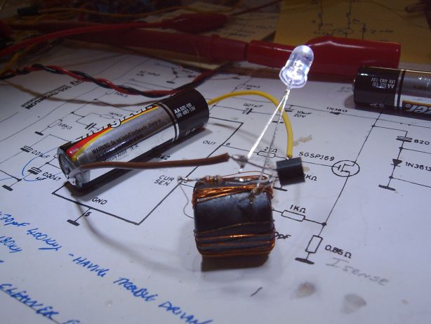

Another joule thief.
:) this was the 1st thing i've ever soldered together elctronics wise, amazed it worked 1st time too. If i stick the capacitor in, how can i measure the efficieny improvement?
You have to measure the RMS current and voltage in and out, which is a little on the sticky side because the frequency is 300khz or higher. (Mine was 360khz on a fresh AA) How Colin qualified his efficiency gain is unknown, I will certifiably guarantee that a single cap did not increase total efficiency 300 percent.

Just as an extra little tid bit, apparently my joule thief has started to behave like a relaxation oscillator. It drew the C sized carbon cell down to about .4 volts, after 4 days it finally stopped oscillating. But the battery voltage is recovering over the period of about an hour to the point where it starts oscillating again as the voltage rises. It's done this a half dozen times so far. I can't even put scope probes on it anymore without causing it to stop oscillating.
I made two units - was a lot of fun. Also looked at the waveforms & behaviour on a PicoScope 5204.
The first one was 20:20 turns on a ferrite I think that was acting as a filter choke on a wire loom somewhere. Used the fine primary winding wire from a burnt out 240V plug pack (wall wart). It ran at ~16khz (1.5V) and is still draining one of the cells that’s also leaking acid. I used a 1k base resistor to limit the maximum brightness to what looked like about 20mA. It will run down to about 0.4V before falling over.
The second one was a powdered iron core from a small battery charger I think. Removed the existing wire, folded it in half and wound it back on for 40:40 turns. It runs at about 40khz (1.5V). It too is dragging down a leaking cell. I used a 5k base resistor to limit the brightness to the same as the first one. It will run down to about 0.6V before falling over.
Both were fun to make, and I suspect they would work using any old junk cores, wire, resistor & transistor laying about. I highly recommend everyone make one of these just for the fun of it. Maybe even give the garden some night lights using old cells.
Oh, I pushed the second unit to about 3V supply and it pulled ~500mA from my bench PSU before the LED changed colours and blew :D
