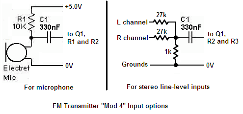

NO! Remove all the components before C3. Keep C3, it is your Audio Input. If there is no LM2931, buy LM78L05 or 7805. It will work because you have 12 V battrey. You can find trimmers in old Radios, TVs. If you feel hard to make this one, make single transistor FM transmitter. It can transmit 100 meter but friquency won't be stable.
Then the pre-emphasis will be removed and it will sound awful like your stereo with its treble tone control turned all the way down or like a telephone or AM radio.
Instead, use the entire circuit but add two or three resistors to mix stereo into mono and attenuate the input signal.
If there is no LM2931, buy LM78L05 or 7805. It will work because you have 12 V battery.
ALL semiconductor manufacturers make many 5V low-dropout voltage regulator ICs.
Oh yes!!
I was just thinking about De-emphasis friquency without ''Pre-emphasis''. Now got simple solution! I will inject mono audio just removing a 27K resistor.
