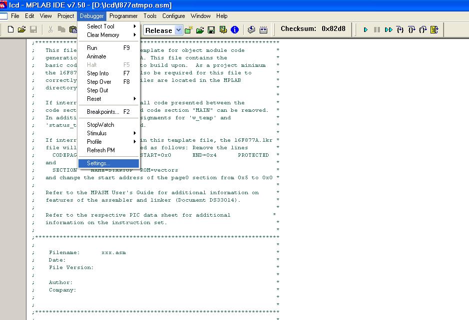

I have just picked up my Junebug again after a few long months! After making LEDs flash, remembering how to debounce switches and finding out how much I've forgotten.. I think I might be ready to do something useful :)
I found a thread from last year. I hadn't played with animate mode before, but it seems really slow.
It takes a few seconds for MPLAB to cycle through. Is this normal? I assume so, which (sadly) makes it a little useless.
Limit the amount of variables you're watching and don't run the 32kHz Oscillator
OSCCON = 0x72
Will run it at 8MHz and debug will go much faster.
Excellent, thanks Bill. I'm sure I've been told that before.. somewhere.. oh yes!

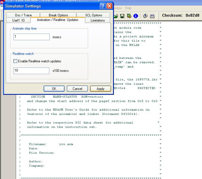

you can make MPLAB faster by adjusting the animation value
(explination in the attached pictures):D
