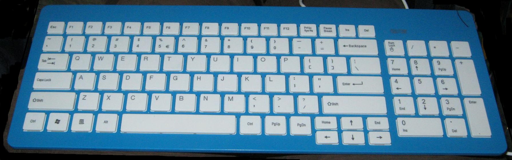

The other news is that i received a somewhat smaller keyboard yesterday just in case i decide to go with a simple uC to Keyboard solution. Simplest would be to interface to two keys, the 1 and the 0 keys, and send binary to the program that way. That would require two small transistors (SMD maybe) or something like that. To get faster transfer i could go with more key interfaces, but there is probably a matrix in can interface to inside the keyboard so maybe i can get all the keys with fewer transistors.
Nice little keyboard though for 10 USD, not as small as i would like but smaller than most. Quite cool looking too.

I'm curious to see the inside of the keyboard. For cost saving they probably used a key matrix directly to microcontroller pins, and the micro would have USB capability built in and provide the HID interface itself, directly to USB cable.
If it's a time thing, your local PC store will very likely have those PS2->USB converter plugs in stock, for a few bucks each. PS2 is very easy to interface!

Im sure you are right about it being a single chip with i/o pins being used to scan the keyboard matrix. That's what makes me think interfacing to the keyboard itself wouldnt be that hard. A few i/o pins with an analog switch :)
When i get around to taking this apart i'll post some pics.
