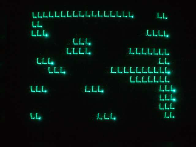

This video is full of small dots.

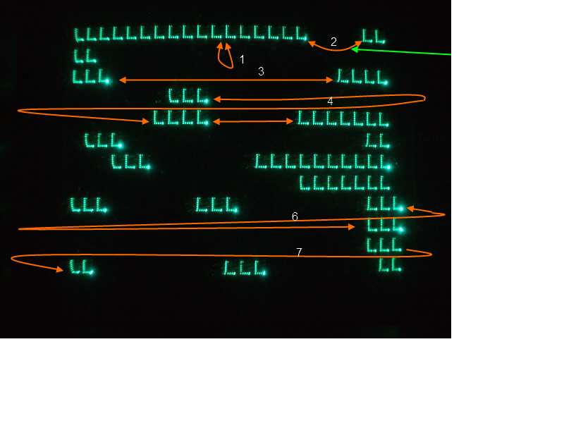

The last one on a character is too bright by 2X and
Any dot that if followed by a long black space is VERY BRIGHT.
I have designed many video amplifiers and can not think of a analog problem that will do this.
I am certain this is a digital problem. See above

This is a timing error. At the end of a character the software goes off and leaves the last dot on, with out moving the dot to the next location. (When I say leaves the last the last dot on I mean; If the dot is on it leaves it on. If the last dot is off if leaves it off)
depending on which direction he is scanning the horizontal and vertical.
I have thought about this. It does not matter if the scan is Left to right or right to left or top to bottom or bottom to top. There is good evidence the scan is L to R.
Note the vertical part of the L does not have "over shoot". The last dot of the L is too bright.
Line 1 shows what happens when the dot is left on for 2 dots of time.
Line 2 shows a bright spot because the dot is on for 4X6=24 clocks.
Line 3 is very bright because the dot is on for the length of the orange line.
Line 4 is also a long line.
Line 6 and the L below it are examples if a long amount of time.
Now compare to Line 7 which is shorter.
If this is a simple video amp over shoot then all single dots should be too bright. If you look at the horizontal line of the L it is made up of 5 dots not a single line. The designer chose to make the video 50% on 50% off for a single dot. This way the frequency response of the video amp (Z amp) is not an issue. One dot, two dots......5 dots all have the same frequencies.

Looks like your right ron, the dots making the chars proves the hardware can do it without bright dots.

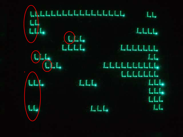

Note that the left most L in each line is distorted. At first I saw the top an bottom left corner had distortion. Now that I look close I see the first L is distorted even then the L is near the center. My thought is that the X and Y amplifiers are being run at max speed (for the first item on a line). Going from L to L the amplifiers seem to be plenty fast. But going from the right edge to the left edge in only 6 clocks of time is a huge jump for the poor little X and Y amplifiers. There are several easy fixes but that is for another time.
Hola Ron,
Your analysis is correct in all counts but let me tell that the picture was taken in my very first try in 2009. As a personal challenge I decided to rewrite the whole code, which was a rather complex one (albeit worked OK).
Just by moving to RAM, the [delta X / delta Y] pairs defining where each dot goes, wrt the leftmost/bottom dot of each char, I could write a quite simple code. The flowchart is definitely a simple/straight one.
By now, the sole thing I need to correct, is the leftmost char in each line coming distorted.

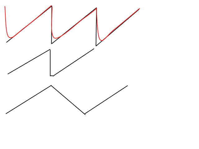

Could you mention now the easy fix for the remaining problem? If it is a delay, up to now I could not minimize the effect.

If you were doing raster scan the horizontal output would look like this, in black. (probably you aren't)
The red line is what happens when the scope is a little slow. The first character is misplaces a little because the dot did not get to the right spot yet.
Fix 1) Add some delay after a big jump. See the flat bottom in black trace two.
Fix 2) Scan Left to Right then scan from Right to Left. (Trace 3. )This way there is no big jump. I have used bidirectional scanning and had good luck.

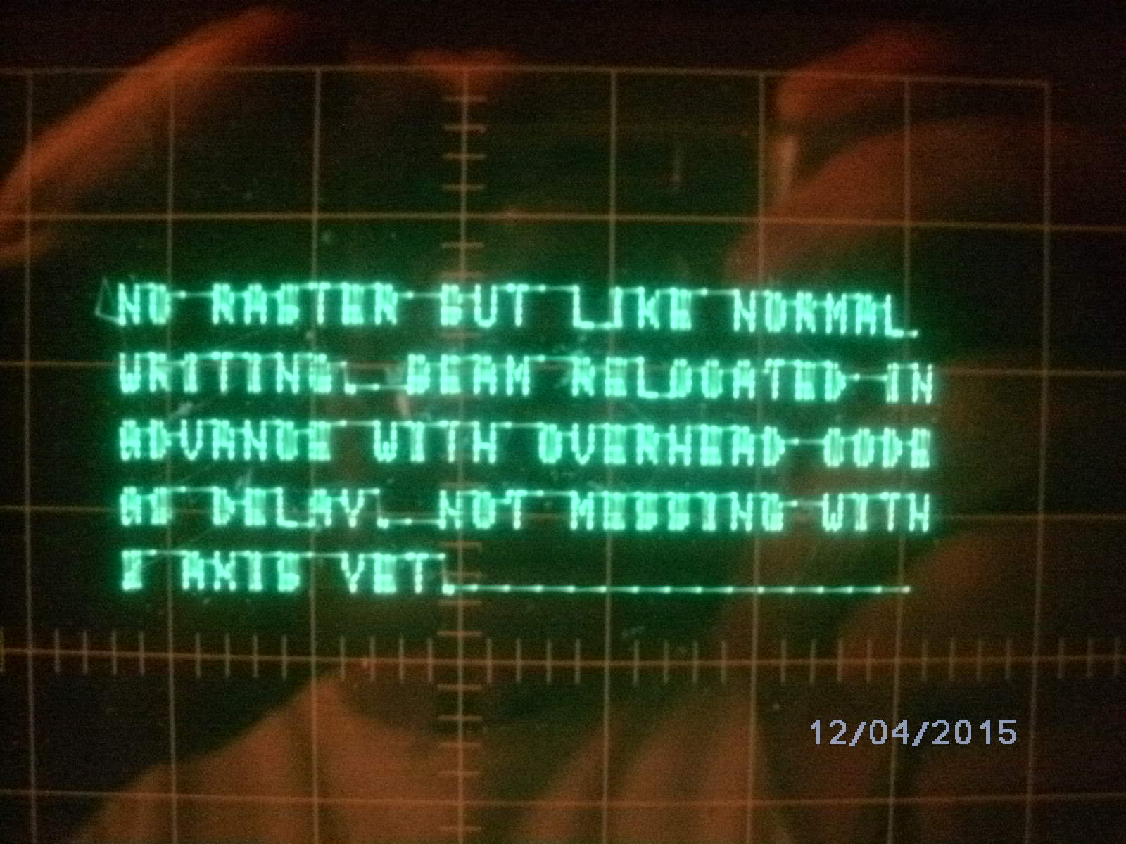

Hola Ron
My self-esteem made me to insist in proper timing instead of going the (not discarded yet) bidirectional way.

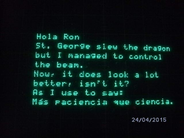

Not messing with the Z axis yet.
Moving ahead as time permits. Beam turned off between dots.
Yes that's cute, and the date came out REALLY good <chuckle>
