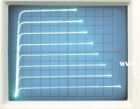

Here is a picture using XY where volts and current are displayed.
Another picture using XYZ.

In a test made long time ago, drawing those symbols ("L" letters if you like), I got some on the leftmost position, notoriously distorted.
Symbols are drawn as in normal text lines from left to right, from top to bottom, one "character" at time (built spot after spot).
Knowing that, you will see that the distorted ones are preceded by a a character on the righmost position in the previous line. Otherwise, no distortion.
I asumed that the beam was arriving late for the first spot in the 1st char of the new line (left bottom spot in the character). In other words, code seemed to be faster than the beam. I still feel it is true.
I recall having solved this, brute force style, applying a 19-NOPs delay (16MHz PLL clock 18F micro) somewhere in the code. I believed that, in that way I was actually "waiting for the beam". Sole thing I can say, the symbols came OK after that.
Since I decided to discard the previous one before reworking anything, I want to know what to look at.

I don't think your problem is the speed of moving the beam, as it's extremely fast, but more a question of you're doing so much moving in order to create a display like this - however, the Z input could be pretty slow, as it's probably not really made for fast signals.
This is a question about settling time to within 1% of target and not about rise time of 1/(1-e) or 63% of the rated slew rate for a given bandwidth. Often this settling time for a 1st order filter is 3x the rated rise time t(99%) = 3 x t (63%) of target
If you are drawing vectors with long retrace from last character (end of row) to first character on next row, them you must allow more blank time for this retrace in order for the 1st "L" in the row to be drawn vertical and straight.
1) It looks like you have to add more NOPs for the wait time for vector draw after large retrace vectors from far right to far left to the 1st character position.
2) It also looks like some bright dots have excessive dwell time before blanking.
3) the blanking bandwidth looks adequate as the dots are "fairly crisp"
4) there is some circular distortion perhaps maybe it is in the photograph but if in the display ...
it means it will need magnetic pincushion adjustment in the corners to flatten the outer rows and straighten the outside columns.

I get them all over simply by building, dot by dot, one char after the other and once the screen is done, repeating the whole business.
Yes after so many saying that, I realized that I've put the focus (no pun intended) on how fast and not on when it settles. I think I learnt something.

This is a question about settling time to within 1% of target and not about rise time of 1/(1-e) or 63% of the rated slew rate for a given bandwidth. Often this settling time for a 1st order filter is 3x the rated rise time t(99%) = 3 x t (63%) of target.
OK. It seems that that is the core of my problem.
So, my solution that reads " wait for it to settle", was right.
Pure bad code, Tony, waiting too long for shifting to next char. It was corrected after this picture.

I know video. The bright spot is because the beam is at that position for a long time.
It appears that after you draw a character you go away and leave the the Z on.
Look at the top row. "LLLLLLLLLLLLLLLL" That looks OK but the right dot is probably on 2x too long. My thought is that the beam is on for the time it would take to draw the black dot between characters.
Now look at the last L in in any line. The last dot is TOO BRIGHT. Because you left the Z on during the black time of the next empty characters. Any time there is a L ahead of a black space, (including the right edge) the last dot is too much time.
