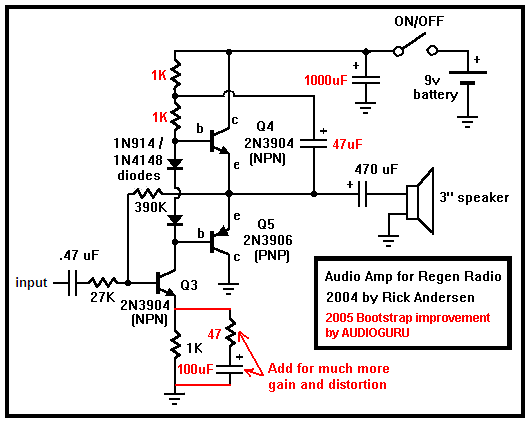

Sorry. I see what might be a transformer on your schematic. If its primary is 10k then the output of the amplifier is only 50 micro-watts max.
You should be using an LM386 audio amplifier IC. With a 9V supply it can provide about 500mW into an 8 ohm speaker, and draw very low current when not playing loudly. 10,000 times more power than your amp.
If you want to make a simple 3-transistor amp then this circuit is fairly good:

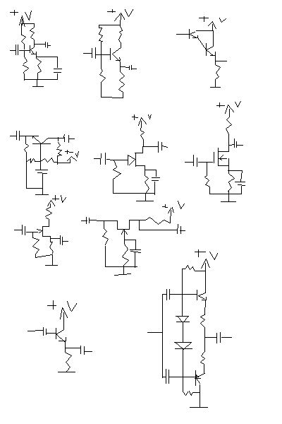

will this detect fm(1fmd.jpg)? (If not please explain better)
And about amps I REALLY cant find radio and amp explenations on the net. At least we could compare the amps in the atacched pic (1amps.jpg)
No. It is just an oscillator. Look at FM detectors in Google.
Some of those circuits invert, some don't. Some of those circuits have voltage gain, some don't. Some of those circuits have a low output impedance and others have a high output impedance. Learn about transistors and you will understand.
