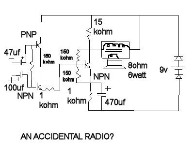

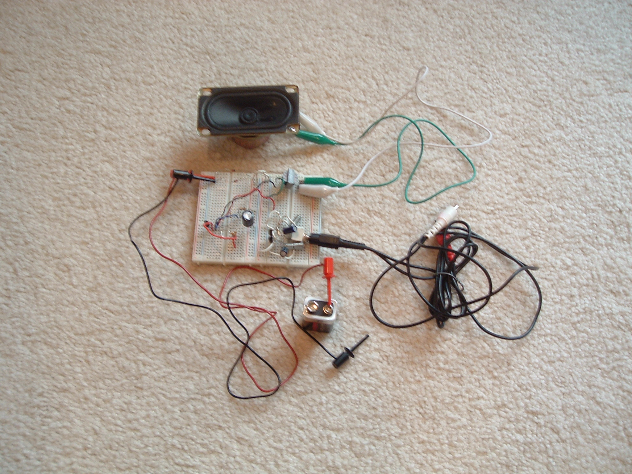

I was breadboard prototyping a reliable amp for my fm radio project. When I made some modifications next day, I heard music from the speaker! I disconnected it from the audio source (which by the way was off!) with the other end in the amp and SIILL I HEARD MUSIC!!! I replugged it and I heard fm distortion. 3rd time nothing. Tried again by touching long wire and telescopic antanna it buzzed with fm distorton upon contact with only 1 terminal. BUT STILL WHAT WAS THE REASON FOR THE MUSIC???!!!

What you heard was an AM station.
The signal from the station is picked up by the unscreened wiring of your circuit.
Non-linearity in the transistors act like diodes and detect (rectify) the AM signal, resulting in the music which you heard.
This is quite a common effect, try leaving a mobile phone near some cheap computer speakers, every so often you will hear the phone communicating with the base station, whether you are using the phone or not.
If you want to classify such a setup as some type of receiver, I would call it an untuned crystal set.

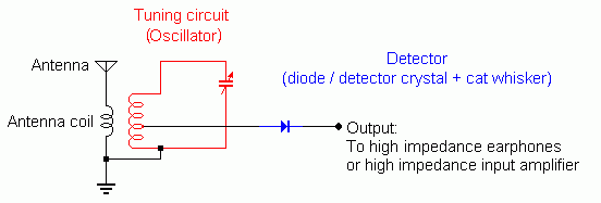

The simplest radio is the crystal set. You can receive AM stations. I uploaded a schematic. This is the simplest pratical receiver.
A Google search for "sintonize" brings up a lot of Portuguese results. Hayato, where are you located? Does "sintonize" mean "synchronize" (or "synchronise") in English?
Hayato
That tuned circuit is NOT an oscillator, it is just a tuned circuit. There is a big difference.

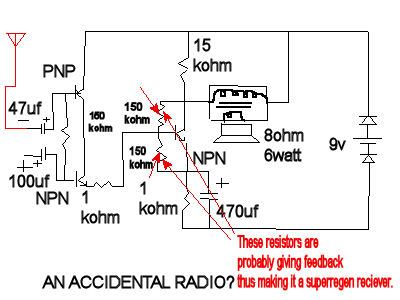

I decided I want to reinforce that phenomenon and make it a usable radio.
catcat said:
Im talking aboum fm superregen here!
A super-regen "radio" detects AM and static, not FM. If it is tuned to the side of an FM station then it detects the FM by "slope detection" because at the side of its tuning the amplitude of the FM changes as its frequency changes. The result is very high distortion and noise.
A super-regen "radio" uses positive feedback to oscillate. Your "amplifier" doesn't have positive feedback.
Your amplifier won't work as drawn. The pic shows a transformer driving the speaker but in the schematic the transformer is missing and the speaker is shorting the battery.
Why does it have two diodes at the battery? Only one is needed to protect the circuit if the battery is accidently connected backwards.
Before making a radio, try making an amplifier that works well. Connect a CD player to your "amplifier" to hear its poor performance then make a real amplifier.
