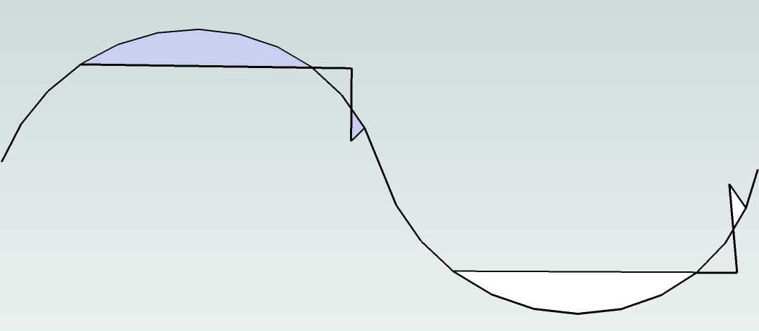

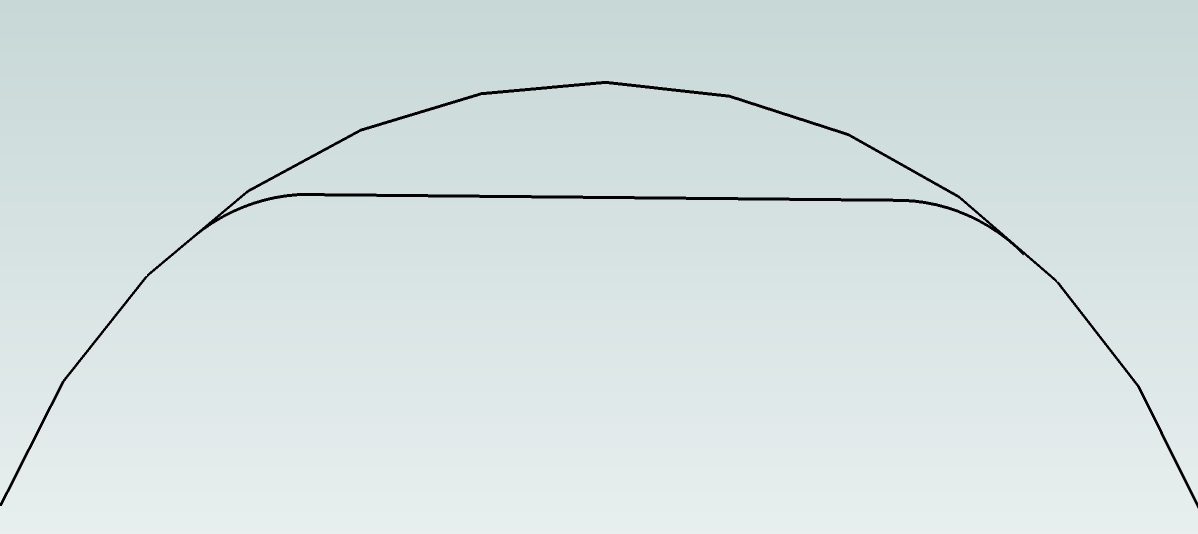

Many audio amplifiers do not clip well. Example 1 below shows the amplifier coming out of clipping slow and then over shoots. In example 2 there is asymmetrical clipping and in the positive direction phase reversal. Example 3 shows what some tube or valve amplifiers do.
(Sorry about the bad CAD drawings)
One advantage of a limiter is predictable clipping that can match a valve amplifier. The limiter is set just below the power amplifier's clipping level.
