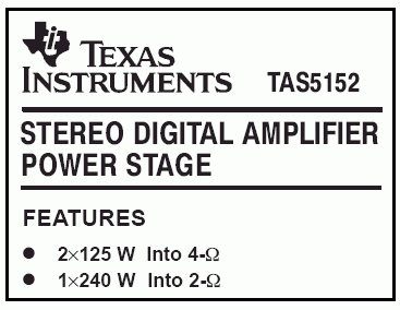

Most audio high-power amp ICs are idiot-proof. They shutdown when they get too hot. NOT A GOOD THING TO HAPPEN IN THE MIDDLE OF DOING A GIG.
TI has a tiny little class-D power amp IC. It is rated at 240 Whats.
Right...but I don't see a lm383 making it to a gig lol.
