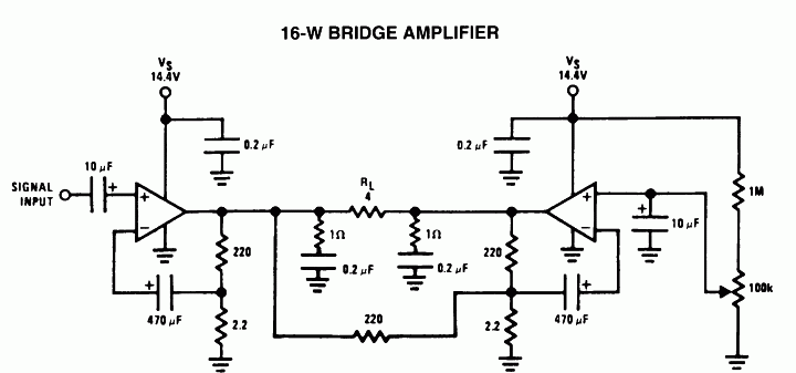

Hi. This is a schematic for a bridge amplifier of power 16w, from the web.
It doesn't actually say what the ICs are, but I couldnt help thinking they looked like 386s.
I know they're not, but could you use 2 386 amps in a bridge like this to output more power than one by itself?

A bridge-connected pair of LM386s would work.
However, I've never seen or heard of this being done.
With twice the voltage swing across the load the current in the output devices will also increase by a factor of two.
Nevertheless I would have a go and see if you can get away with it.
You might like to consider gluing a token heat-sink on each i.c.

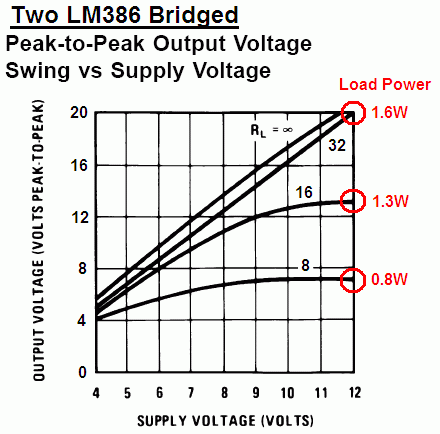

The LM386 is a 1/2W into 8 ohms amplifier. With a 14.4V supply, it seems to be current-limited or just runs out of current gain at 1.1W into a 16 ohm load or 0.7W into an 8 ohm load where it also reaches its maximum temperature. With a 4 ohm load it reaches its maximum temperature producing 0.3W but only with a 10V supply since a higher supply will only cause more heating.
In a bridged amplifier with a 4 ohm load and a 14.4V supply both LM386's would try to operate far beyond their thermal limit but current-limiting would allow hardly any output power. They would also have the same problem with 8 and 16 ohm loads. But with a 32 ohm load they would be able to produce 2.2W and not get too hot.

Connect a 0.1 ohm current-sharing resistor in series with each one and connect 6 amp/resistors in parallel on each side of the bridge. You should be able to get about 15W into a 4 ohm load without a heatsink.

You don't need a schematic to connect a 0.1 ohm resistor in series with a LM386 amp then connect 6 of them in parallel on each side of the bridge.
Actually, a schematic might be a good idea since most of the amp input capacitors aren't needed in your circuit when it uses LM386 amps, because their inputs operate at 0V. The output offset voltage adjustment pot also probably isn't needed.
That's right, with a 14.4V supply and an 8 ohm load only a total of 6 of them will provide about 9 Watts, but of course without a heatsink they will get just as hot as 12 of them providing 15 Watts into a 4 ohm load, but still within their thermal limit.

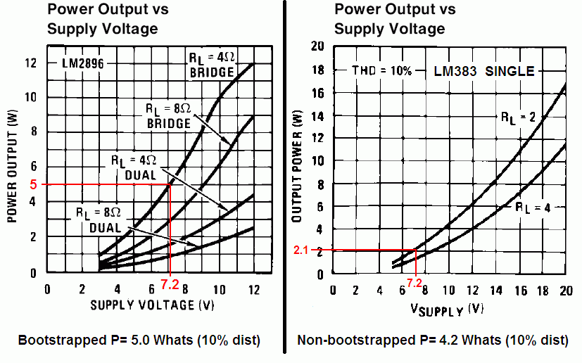

Hi Nigel,
My bridged amps were operating with a 7.2V battery and bootstrapping allowed about 20% more output power when compared to similar amps with current sources instead of bootstrapping.
I have compared the bridged LM2896 bootstrapped amp driving a 4 ohm load that I used, with the similar but non-bootstrapped and non-bridged LM383, but it is driving a 2 ohm load to give the same current as it would have if bridged into a 4 ohm load. Since the curve is for only a single LM383 amp, the output power is doubled when bridged:
