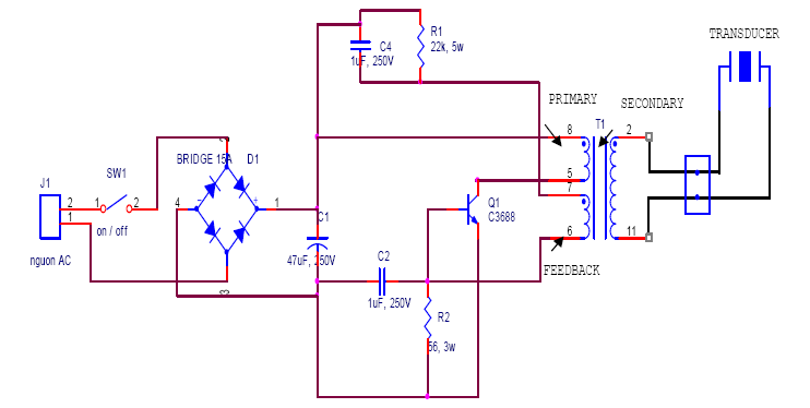

I must do a project about "Ultrasonic Bath"but i don't have any experiences in this field. Please help me with this circuit:**broken link removed**
How can we choose the number of wire-ring of the primary and secondary of the transformer to get the maximun Frequency of the Tranducer?

Here i attach the circuit for you! Pls help me!

Look at Blocking oscillator in Google.
Most circuits oscillate at only 400Hz which is too low.
I made a 'joule theif' earlier in the week, it's a simple blocking oscillator and it's running at around 50khz

But can you show me something more detail? Let's consider that the frequency is about 50khz. But how could we choose the number of wiring for the Primary and Secondary of the transformer to get that frequency?

More turns means more inductance means slower frequency. The transistors capacitance and the inductors inductance at the operating current will determine the ultimate frequency this is generally something you guess at, if you need a sepcific frequency there are better oscilators.

You mean that "if the turns is higher then the frequency is lower"? So how could we know that where is the best of the turns?
You've already said that you did a project and your frequency is about 250khz so how about your turns? Can you give me some information about your project
250? No it was about 50k.
It was approximately 20 turns of 30 gauge wire wrapped as two stacked coiles on a toroid.

The Joule thief has a 1.5V battery and has an output power of about only 0.0075W. It uses a low voltage, low current little transistor.
Your ultrasonic bath circuit uses a 323V supply (the 230V mains rectified) and has an output power of maybe 7.5W or more.
Its 2SC3688 big power transistor is used to make the horizontal deflection and high voltage in a colour TV and is rated at 1500V, 10A and switches very fast.
Your transformer probably has a ferrite core, has very low capacitance and is probably a voltage step-UP type.
