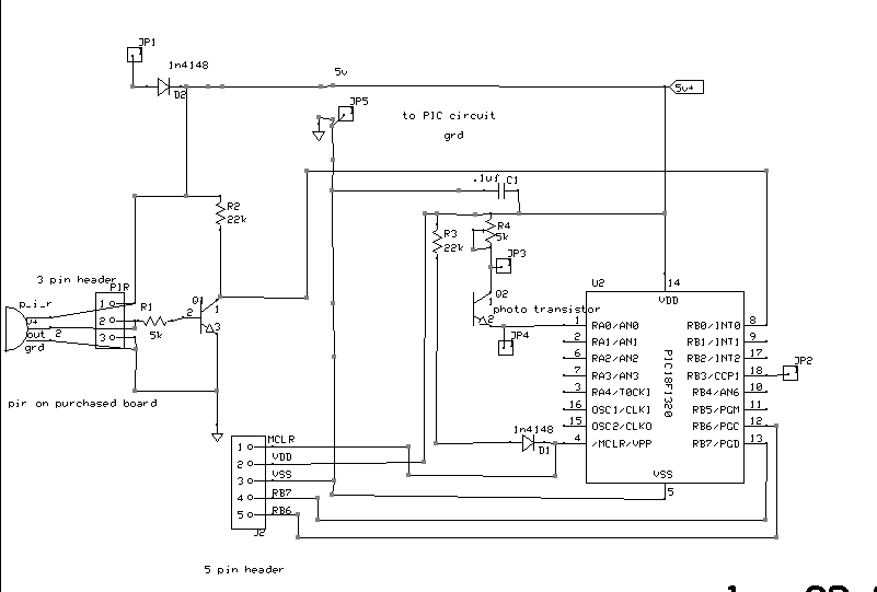

the battery powered unit only needs 5v. The present PIR units only draw 5ma at 5v
the new PIRs only need 3.4v but thats taken care of if using a 9v battery pack and then use a LDO voltage regulator for 5v(PIC) and a zener for the 3.4v(or a voltage divider.
here is the present schematic that is powered by 3-AAA batteries
Piezo output is jp2
