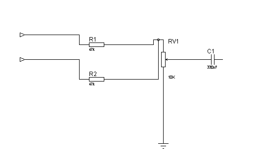

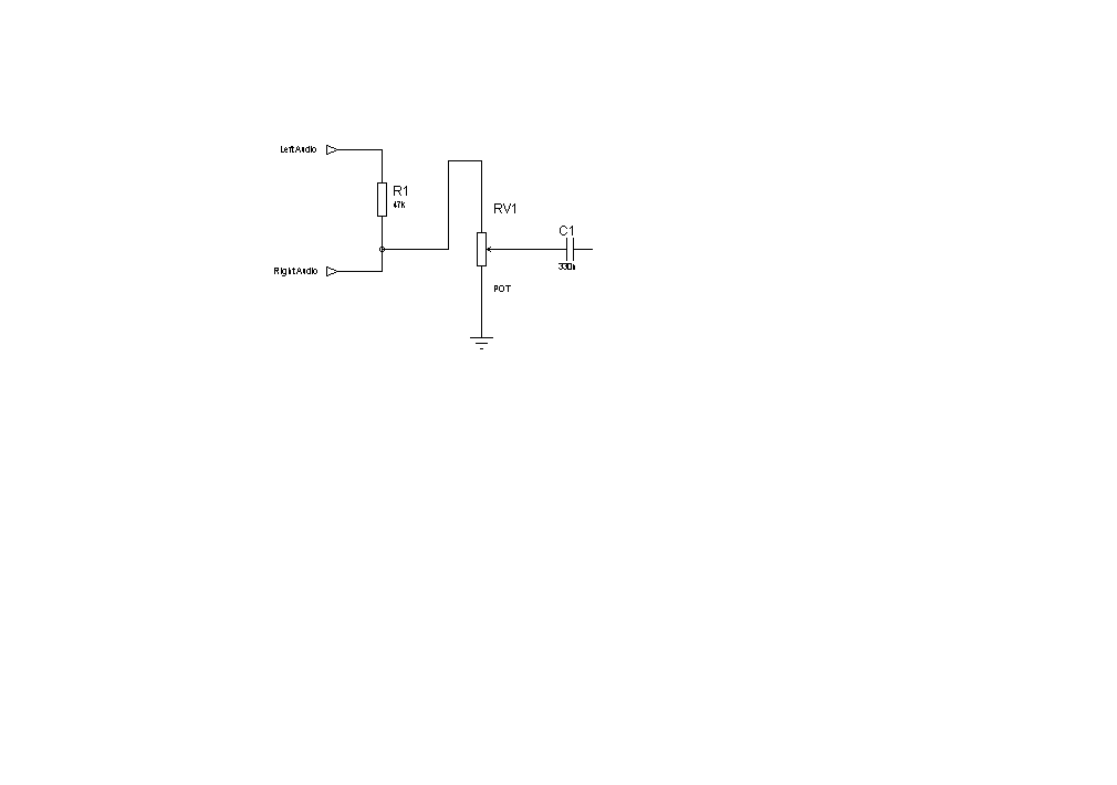

on the output jack there's GND left and right, If you want to combine left and right channel what can you do, connect them together? or just ignore one?
Connect them together via a 47k resistor.
Rather than connect the resistor as you describe.
Use a 10k resistor and connect is R1 is in the schematic below.
Do you mean something like
I don't quite get the 47K part.
RV 1 is right.
Sorry I should have said you need two 47k resistors, one for each input.
Yes, that's right.
