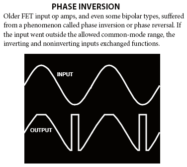

TL08x and low noise TL07x opamps produce a unique kind of distortion. If an input voltage gets within a few volts from the negative supply voltage (which is usually 0V in a pedal circuit) then the output suddenly goes as high as it can. It is called Opamp Phase Inversion.

A 7660 produces a 10kHz whistle that most deaf electric geetar players cannot hear. If you use the boost-frequency pin then the battery runs down sooner. But the opamp phase inversion can still happen if the input gets within a few volts from the 10kHz modulated negative supply voltage. I think the sound has raspy even harmonics (frequency doubling).

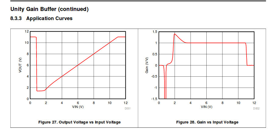

that's always a nasty surprise... according to the data sheet, this happens when the input is within 1 volt of the negative rail [data sheet] it's on pgs 29 and 30. there's additional app notes [here] and a complete tutorial about op amps (originally published by Burr-Brown) [here].
1V is nothing, the datasheet shows 4V.
Page 29 of the datasheet you linked and the Recommended common mode input voltage range is 4V above the negative supply up to the positive supply.
these curves show the phase inversion as being at just under 1 volt from the (-) rail.

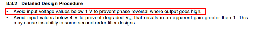

and this is what it says about the curves:
All graphs on a datasheet are for a "typical" device that you cannot buy. Some of them are better than typical and some are much worse with the range shown in the printed spec's. The recommended common mode input range is 4V more positive than the negative supply which is ground in that circuit.
Don't electric geetars blast the levels too high producing clipping (fuzz) which causes the input of the TL07x opamps to go close to the negative rail and produce the phase inversion no matter if the opamp common mode input range is minimum or maximum?
