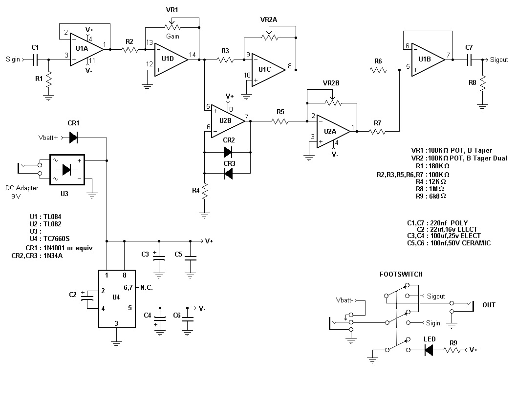

Here's a distortion pedal I designed a while back.
It's called "MJ's Hot Mess."
U1A is an input buffer. C1 / R1 as well as C7/R8 control the low frequency cutoff.
Tinker with these values to make a Bass pedal. ;)
U2B is the heart of the distortion pedal. I believe the configuration is called a logarithmic amplifier.
The diode pair makes all the difference here. I use a pair of 1N34As, which are germanium diodes.
U1C and U2A comprise a mixer. You can mix the clean and distorted outputs together.
If you use this circuit, don't forget to mention where you got it.
You won't find it anywhere else but electro-tech-online. ;)
Best o fluck. (This is a typo that I think I want to leave alone, just for the comedic effect.)
Uhhhh...best of luck. :)
If you are making several copies of your circuits, you can lay out circuit boards as Gorphert suggested, but instead of etching the boards yourself, you can have 10 boards professionally made in China for around $25 all-in ($5 to make the boards, $20 for shipping). That's just for the printed circuit board to replace the veroboard. Then it would be a lot easier to assemble.
MJ, when I first looked at your circuit I assumed that the fuzz and direct path gains were independently adjustable. Now I see that the two pots are ganged, so ...
Since R3, R5, R6, R7, and VR2A and B are all equal values, you can eliminate two opamps and 1/2 of the dual pot by summing the fuzz and direct paths into the output buffer and making that stage adjustable gain.
ak
AnalogKid: Thanks for the heads up. I thought it would provide a better control of the percentage
of clean vs distorted output. Like a pan pot.
Problem is, I don't play guitar, so it's difficult to determine what guitarists like.
When I get a chance, I'll try the mod you suggested and ask a few guitarists I know to try it out. :)
Now that you say that, I understand why the two pots are connected differently. To improve clarity, add pin numbers to the pots. Pin 3 is the terminal the wiper goes to in the full clockwise direction.
Yes, your dual pot will act as a pan between max fuzz and max clean.
