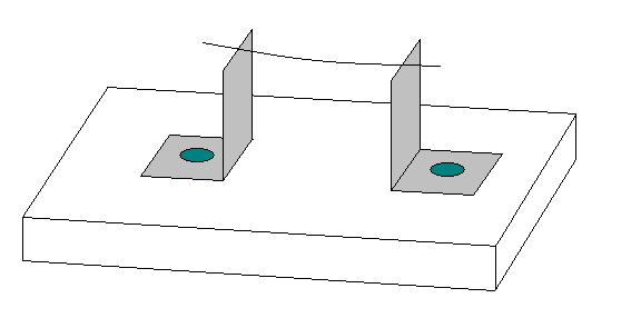

I think you can use a lot of different materials, so long as the contacting surfaces have a lonlinear V-I curve. I once detected a local radio station with a contraption that consisted of two pieces of a tin can (plated steel, actually) bent into L shapes and nailed to a board, with a piece of fine wire laid across them, as in the drawing below. Needless to say, it was highly microphonic, which was probably what I was actually trying to achieve. I remember I had it connected to some long wires that went to a friend's house. We were trying to get some sort of intercom going. The wires acted as an antenna, and the oxide on the wire/tin as the detector. The result was quite a surprise, as you can imagine.
