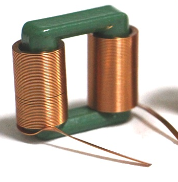

This coil/inductor is wound with flat wire not round wire. You can see how each turn makes a capacitor. (copper insulator copper)
120230
Look at the huge gaps in between the wires. The inter winding capacitance is much smaller.

i know the caps!? well they have been tested for leakage and the electrolytics are new Sprague Atoms. huge ones, two in each can, so in order to make it fit better, i had to use some motor capacitor-cans, i know this is very old school, but overall a very fun but expensive project, the inductor should be in the round brass dome, the only thing that is new in this thing is the PT, the electrolytics, and the output transformer. i will try to make this inductor, i have already bought the items i need to make one, core, wire, mylar tape and so on. I will give it a try, but yes i am concerned about the results, this could maybe be wasted cash.

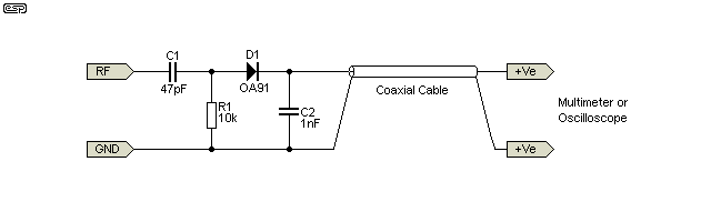

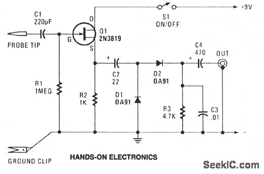

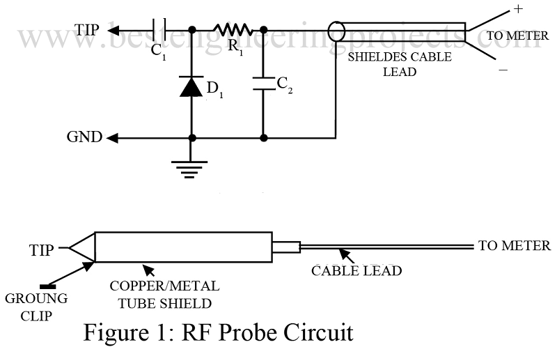

Make a "RF probe" or a "demodulation probe" for your meter. Use the circuit from the internet. (ok most internet circuits do not work)
probe
Because we want to use it at a lower frequency than "RF" you might use 10x or 100x larger capacitors than normal.
Put the signal generator across the coil. The coil should short out the signal. Put the demodulation probe across the coil and set the meter to low voltage DC.
Sweep the signal generator and try to find a frequency where the coil 'opens up" and you get a large signal.

There are several different ways to build one.
It is basically a untuned "crystal radio detector". The idea is that the RF is too fast for the scope so we detect the RF and get the audio to look at.
I think a lower frequency version can be made to detect the presents of AC that is to fast for the meter.
Thank you, that is very interesting,
I would then have to up the capacitors yes, i think i will try it out, i would just have to figure out where to get a cheap probe i can modify, or i can of course do this probe circuit in a different form.
I think you can just use a coax or twisted wires to a meter. Nothing fancy. The output will be DC to audio. The point to turn fast AC into a DC level you can measure.
