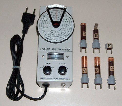

Picture of a grid dip meter. It is a oscillator and some coils. You can scan from a low frequency to a high frequency and see if your unknown coil resonates at some frequency. Very handy tool.

I suspect a grid dip meter wouldn't help much, as they are for RF, and you're looking at MUCH lower frequencies, which is why it doesn't matter.
Q - How do you couple a Dip Meter to a toroid coil?
A - In my experience, with difficulty.

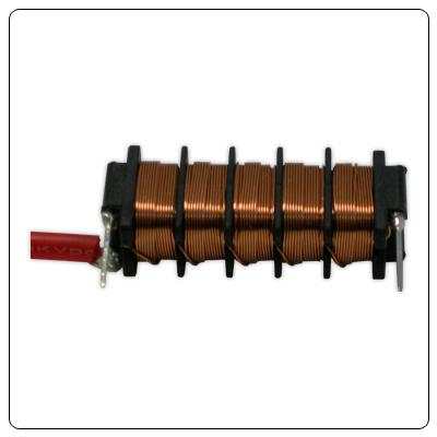

I have done this to reduce the capacitance.

The idea came from how high frequency flyback transformers are made. Slot winding makes the coil into several small coils.
Very interesting thanks for the tip, i found this technique.
