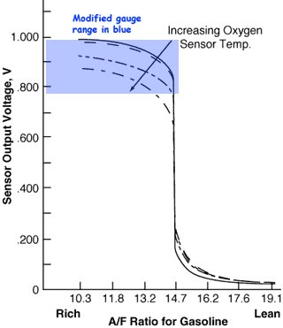

You will notice that when the o2 sensor gets hot~very hot, it will not give proper voltage to air-fuel ratio above the 14.7:1 ratio.
Mounting the sensor as far as possible from the exhaust manifold may be benificial.

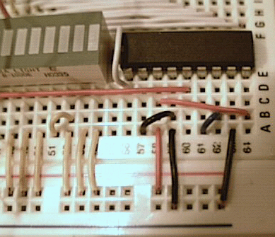

Well sorry to bump this again.
I rebuilt the circuit as posted in my fist post, I did not add a voltage regulator this time. and used a 4.7k ohm resistor instead of 1 ohm.
It worked for about .5 seconds :) then something went wrong. I rechecked all my traces and found some were grounding. After fixing this the circuit does not work.
All the traces are good.
There is 12.2 volts to pin 3 and to the LEDs
The Input pin (pin 5) shows whatever Voltage I'm sending to is (say .200v)
The output Pin on the LM3914 show 10.58Volts(all of them) That's not normal is it :)
Any ideas what's going on? any information you need to help me more. Pretty much going to scrap this project and just buy a damn guage.
Use a 4.7 meg (4,700,000 ohm) resistor !!!, Not 4.7k (4700 ohm).
It will not work if using 4.7k
or, dont use one at all, but then you will have to wait for the sensor to warm up before the sensor will start reading.
dont loose faith.
you dont even nead any resistors in the whole circuit, as the chip is programed to read 1.2 volts when no components are connected to it. eg
Remove all components except for the Leds.
connect pins 2,4 & 8 to ground.
connect pins 3 & 9 to positive.
connect pin 6 to 7.
connect O2 sensors positive signal to pin 5.
connect O2 Sensors negative signal to your circuit's ground.
Thanks Screetch, I abandonned it for the weekend but I'm going to get back at it tonight, will a 10 Meg Ohm resistor work as well?
10meg is the same as not having a resistor at all with this particular circuit.
With a 10meg resistor, the meter will work only when the O2 Sensor has warmed up, ( I know because i tested it).
Any less then 4.7 meg, and it will leak some voltage from the O2 sensor to ground. (meter will show less voltage)
You previously used a 4.7 Kay resistor, and it made all the voltage leak to ground, thats why zero voltage was detected on your air-fuel ratio meter.
HINT FOR ALL: The O2 sensor will ground it's self to it's ground wire when it is warm to hot. the meter freeks out when it's cold because there is no ground. Thats why we put a high ohm resitor to ground(xMega- ohms).
good luck with it Gotrek.
