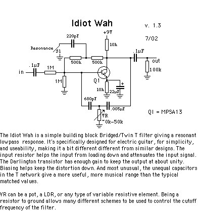

Try a "Twin T" type.
A guitar wah pedal schematic is a good starting point; some inductorless types use a twin T filter, as in this schematic - a bandpass tuned by a single variable resistance:
https://img.scoop.it/8hV7xC91D_C_wCNsxFIdhzl72eJkfbmt4t8yenImKBVvK0kTmF0xjctABnaLJIm9
The principle is an inverting amp with two feedback paths.
One is the two resistors plus capacitor "T", top left in that diagram.
The other is two capacitors plus one resistor T at the bottom.
It's only a single movable band but quite simple and a fairly dramatic effect.
Note that generally you will not get a really sharp cutoff with a single stage of normal RC filtering, more a "tone control" type effect.

Thank you so much, Ill have to read into it but this already helps me a great deal!
You can also employ an universal switched capacitor filter, like the MF10, which are clock tuneable.
The clock can be built around a 555, which would allow frequency to change with a pot.
EDIT; regardless of the method you choose, 20 to 20,000 Hz is a very wide adjustment range to do it reliably with a single pot. You may want to also adjust the timing capacitor to divide the span in shorter ranges. I.e. 20-200, 200-2000, 2000-20000 Hz.
