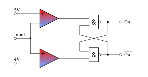

Hi. I did a simple schematic a time ago since I had the same question.
On this particular drawing, the trigger levels is set to 4 and 5 volts.
wow that is a pretty cool idea! So I would just use two pots to set the voltages feeding the two voltage ref points. So if the voltage ref on the top OP Amp is lower than the bottom one will the output be inverted?

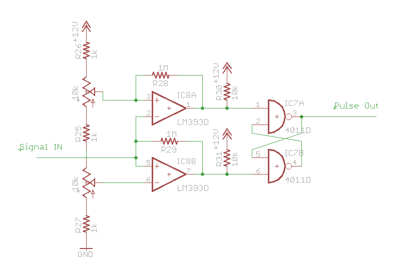

So what about the attached circuit?
I chained the two pots that created the ref voltage so the top one is always higher than the bottom and spaced them with 1K so the voltages never go to the rail values or overlap.
Since these are 339 I added pullups to the outputs.
I added 1M positive feedback resistors to add more hysteresis to each comparator.
In the past I have had issues lm393/339 false triggering due to noise (from pcb layout issues) and I want to make sure these are pretty solid.

I would say not use the feedback resistor because I think the circuit R29 because you make some vey odd input impedance to the circuit.
Personally I wouldn't bother using any feedback resistor because once the SR flipflop sets active, it stay there, no matter what voltage you get from pin1 on your opamp.

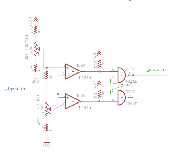

Attached is the new configuration.
Looks ok. Have in mind that window size will change whenever VR1 changes.
That is exactly what I want to have happen (variable hysteresis).
That's not hysteresis, it is change in the size of the window. As drawn, your circuit will trip within a window based on the two reference inputs to the comparator. There is no hysteresis.
Ron
