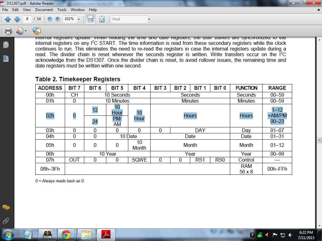

Hello,
One thing more i want to say is that
how to use 1–12 mode hour in Ds1307?
right now the time is 18:12 i want to make in 12 or 00:00 mode only.
DISP[3] =(Time[2]>>4)&0b0001; // for hours 10th how to turn on for 11 mode??
DISP[2]=Time[2]&0xf; // for hours unit
DISP[1] = Time[1]>>4; DISP[0] = Time[1]&0xf; // for min
Bit 6 of the hour register (register 2) controls the 12:00 -> 24:00
If you set this bit then bit 5 is 0: AM or 1: PM..
If this bit is unset then bit 5 is 0x20 to allow 20~23 hours..
So you need to set bit 6 every time you write to the RTC... Then mask bit 5 for AM / PM
