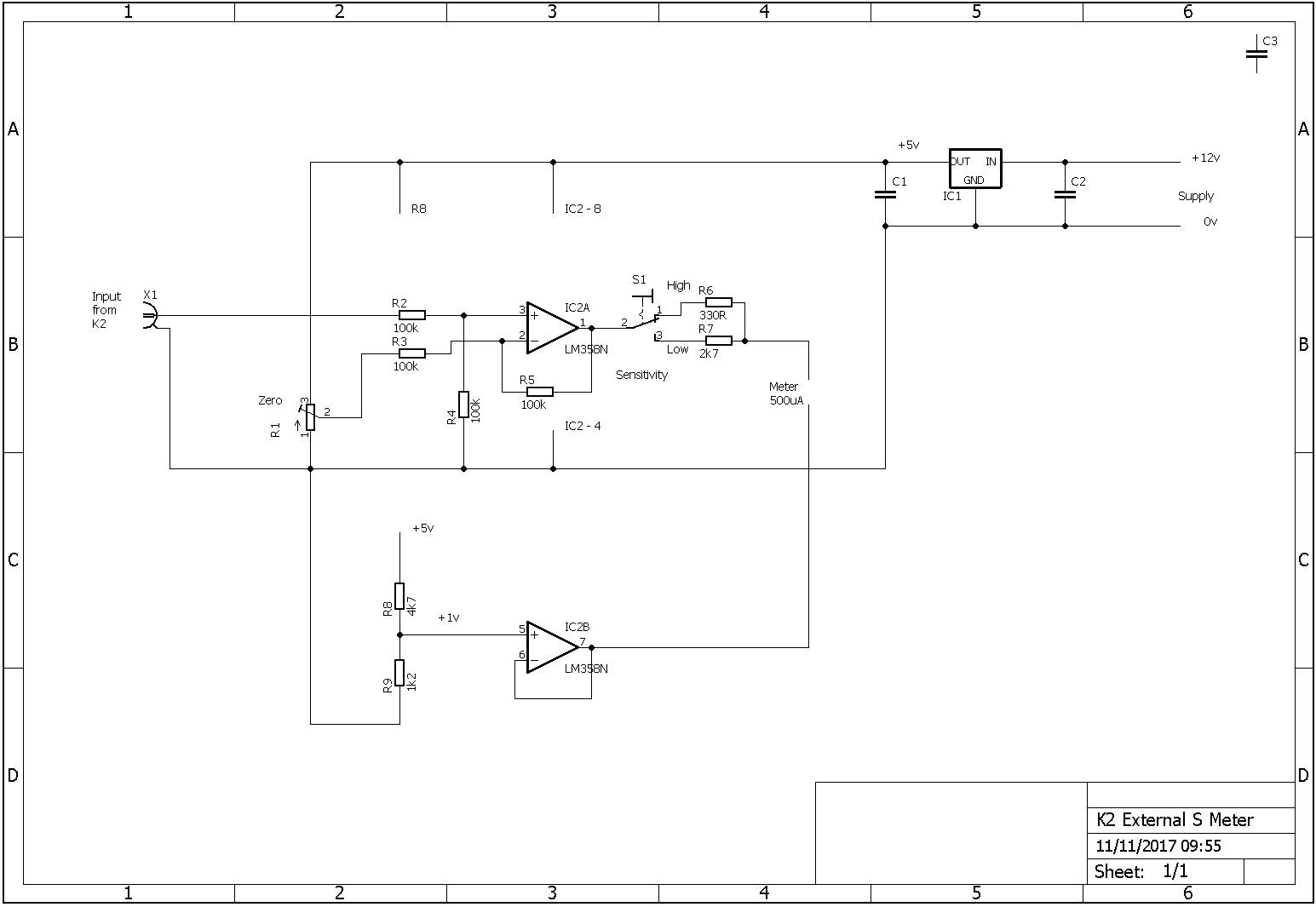

I have a broadcast am/fm/lw receiver I use for 162kc time code reception, they used to broadcast audio but now its just a psk modulated carrier so its hard to tune with a cheap radio.
I found the agc filter cap for the am side, it has 1v with no signal and 0.8v with a moderate strength station, as expected the higher signal the lower the voltage and therefore gain.
I was wondering how to roughly calibrate either a meter movement or a Lm3915 as an S meter, would the max signal be about 0.6v?, as f ar as I can tell the agc bus goes to the mixer/osc and the first of 2 If stages.

I would be inclined to use a moving coil meter which has infinite resolution, rather than an LM3915 which has just 10 discrete level indications. Fine tuning using such a meter is quite frustrating. (Been there, done that, and would prefer not to do it again.)
In terms of "calibration", unless you have a signal generator with an accurate output attenuator, probably the best that you can do is to find the strongest signal in the frequency range which interests you and make the meter move to about 95% of full scale when you receive this signal. And of course set the meter to read 0% when there is no signal.

Using a couple of op-amps, you can pick off the AGC voltage and make some offset and scaling so that the meter reads from zero to 95% or whatever you choose.
Here is something which I made a few months ago for an Elecraft K2 transceiver, which has the dreaded 10 LED "blobs" for an S Meter.
The K2 has an AGC voltage which increases with increasing signal strength.
This circuit of mine has two sensitivity ranges, because a wanted a position where I could have a meter sensitivity of just 2 or 3dB for zero to fullscale.
In the low sensitivity position it has the normal sensitivity of 0 = no signal, to full scale = 2 or 3mV at the antenna (ie very strong signal).

I've lashed up something similar, an lm358 but I connected the agc bus to the inverting i/p, biased the non inverting input to 1v the zero signal voltage of the agc bus, it works.
But I found the op amp wont go quite to ground, so I'm going to make the thing a summing amp and use the other i/p to offset the agc voltage so its starts at the mid rail voltage, so the meter see's 0v with no sig.
Point taken about the analogue meter, I think I have something knocking around, it would have to be an edgewise to get it in. I have a sony comms rx more of a fancy radio, it has 6 leds that are on or off, a lot of japanese or chinese stuff work like this, at least the Lm3915 cross fades the leds.
I was thinking for calibration to connect my uncalibrated sig gen to my 'posh' comms receiver adjust for 0db at the freq of interest, then connect the cheapie rx'er and adjust the pot for 0db, might have to do that for no sig and 0db to make sure the zero and span are fairly close.
The AGC volts on the K2 run from 3.3v with no signal to 4.45v with an input of -50dBm (about 1mV), so there was no problems with rail to rail capabilities of the inputs of the op-amp.
But for the output, I used the second half of the dual op-amp to provide an offset of about 1v for the -ve side of the moving coil meter, so that the op-amp output is well within the available range.

Theres a possibility I'll be connecting this to a uP so I was trying to get the meter to be ground referenced, I spose I could use a different ground ref for the atod.
