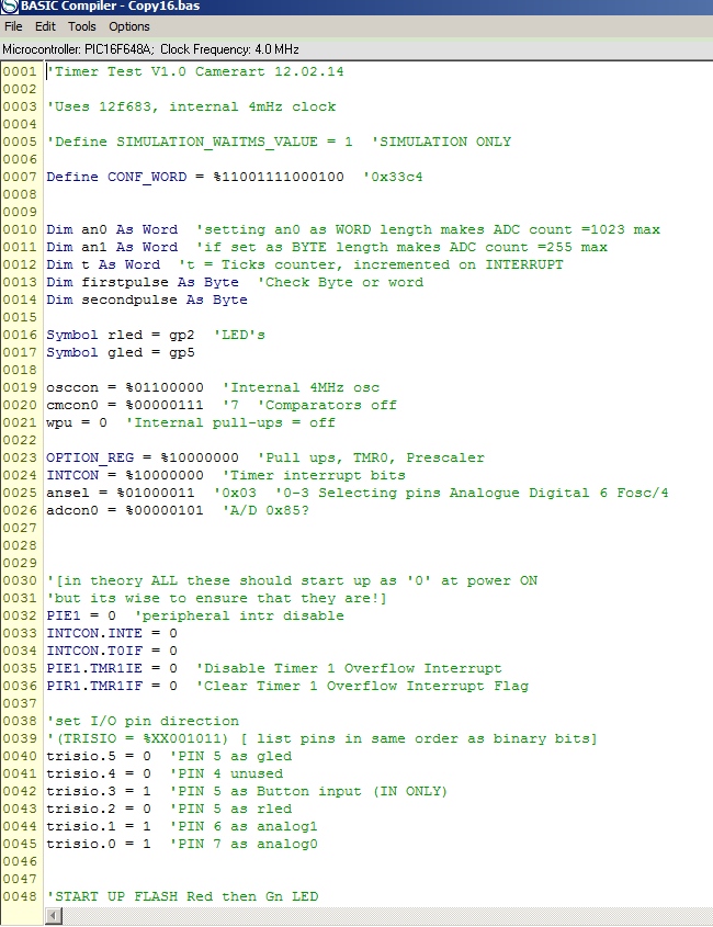

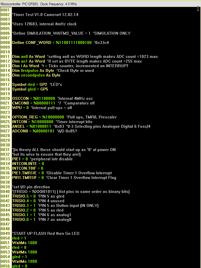

I was looking at the code on #62. It in order that in Oshonsoft LINE19 'osccon' and other variables below it, are lower case and black, and haven't 'come alive' in the same way that INTCON has?
Cheers, Camerart.
I have just opened #62 code and this is an image of what I see in OS, looks OK.
Can you post a screen image of what you see.?
Eric

Attached screen shot of 'copy16.bas'
:rolleyes:Just noticed!! After checking the new ZIF socket with 8PIN and 18 PIN PICs I had left the 18 PIN by mistake. That solved it, sorry.
Camerart
