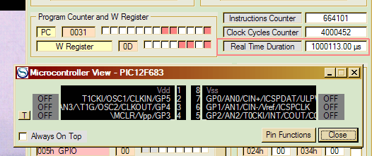

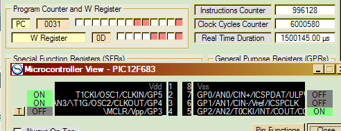

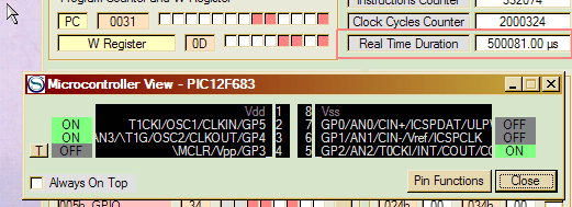

I have run the program in 'real' time, look at these three images, they show an interval of 0.5sec LED ON/OFF as you would expect.
Is it possible you have a damaged PIC on these two pins.??
