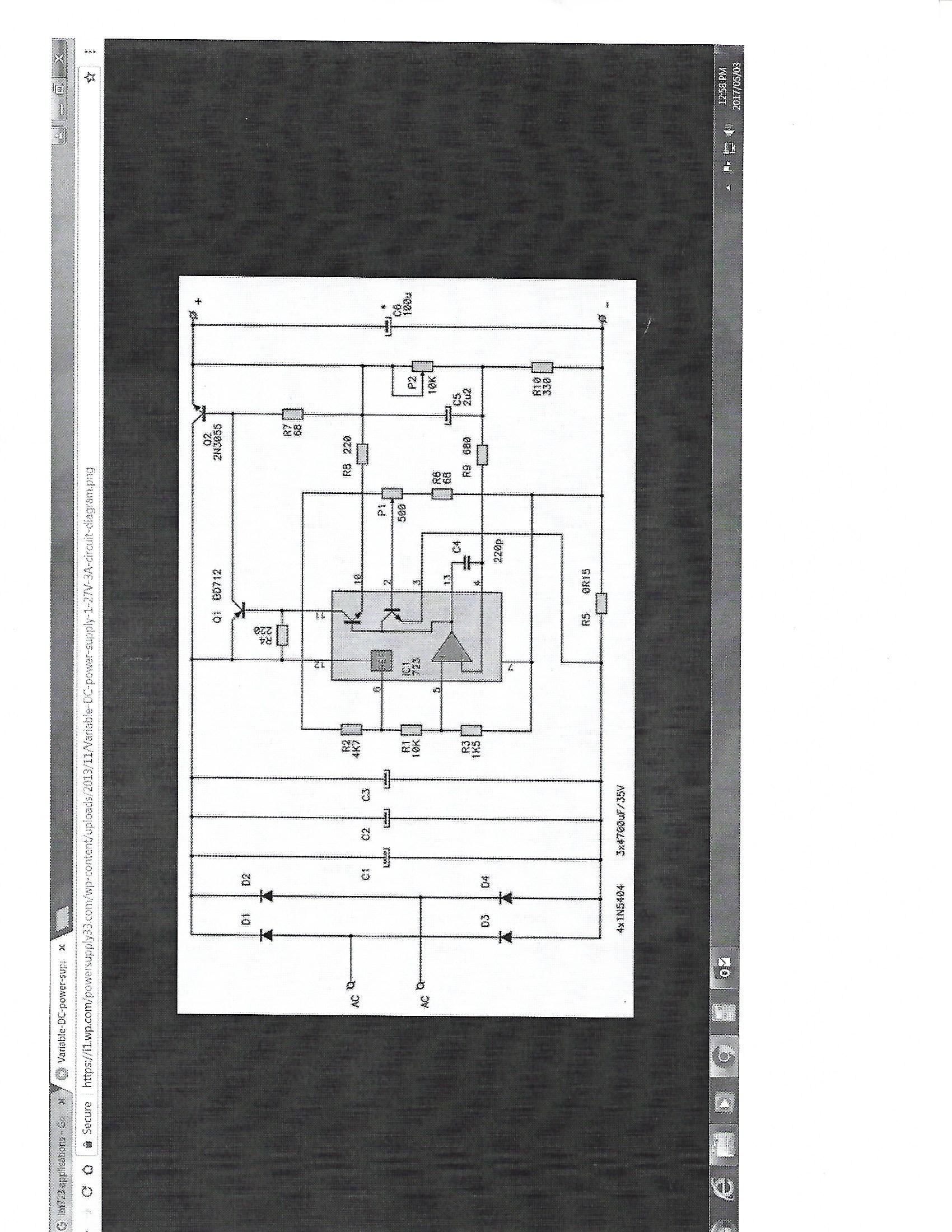

Hi Dr Pepper, Mr Al and all other helpers
I have build the circuit shown in my post. It works quite well and I am happy. Not my design. The problem is that I also need a simple LED indicating current limiting. I tried the arrangement that Mr Al suggested to Dr Pepper with the BC107 or BC 547 as shown by Dr pepper. My tranny is connected in the same way as Dr Pepper except I tried various base resistors but LED stay off. HELP???

The circuit in post 9 is very simple, if you just want max current protection or charge batteries it works well.
The circuit does depend on the Bc547/Bc107 being reasonably matched to the transistor in the Lm723.
Triple check all your connections including the Led.
Just an idea, may or may not work, break the connection to the base of the transistor switching the I limit Led and put a 330 ohm resistor inline, and do the same with pin 2 on the Lm 723, put another 330 ohm inline with it.
This will attempt to balance the forward voltages out on the base emitter junctions.

Thanks for the feedback. I will try the 330R resistors. I also want to make sure I understand correctly. Does the first circuit you have posted, the one with D5 and R5 work ok because I also will try it. Am I correct that if I use this circuit I still need to use your current arrangement LED with the BC107 tranny or BC547 etc. D5 is just a current source LED and does not indicate current limiting as well.

However I dont remember any problems with it, just that the Led lit up just before, or just after limiting took place, by a few mA.
The triggers comments are valid, stabilisong temperatures of the ext and int trannies is a good idea.
Let us know what you do and if it works or not.
Thanks I rechecked my connections against your hand drawn circuit and relized that I must connect the base of the tranny driving the cl LED directly to pin 2 of IC and walla it works nicely now. Again thank you. I get 20V at 2.13A.
