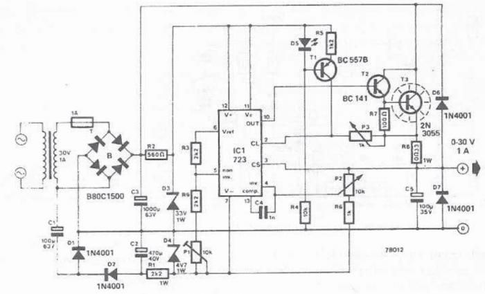

I found a schematic for another lm723 supply here:
The documentation doesnt say what d5 (led) is for, it looks like it might be a current limit indicator, hence my interest, if so how does it work?, I'm more used to microcontroller circuits.
I had an idea for a current limit led before I found this schematic, connect the base of an npn tranny through a resistor to the cl pin, and the emitter to the cs pin, then connect the cathode of the led to the collector, and up to the supply for the '723 through a resistor, basically connecting the tranny that switches the led base emiter accross the current sense resistor, so that what the vdrop > 0.6v the led comes on.
Which should I go for my idea or the attached schematic.
The led D5, resistor R5 and transistor T1 are a constant current source of about 1mA = (Vf - Vbe)/R5 assuming Vf =1.8v, Vbe =0.6v, R5 = 1.2k where Vf is the forward voltage of the led and Vbe is the base - emitter voltage of the transistor T1. The 723 current sense circuit is the base - emitter circuit of an internal transistor and needs 0.6 volts to start limiting the current so the additional voltage drop caused by this current flowing through P3 enables the output current limit to be set to zero ( when 1mA x P3 resistance = 0.6v). You could add another transistor between pins 1 and 10 (check the schematic on the datasheet) and use the collector to drive an led to indicate current limit, the idea you mentioned in your post.
Timescope
If you can afford another 0.7v drop i'd go with the additional transistor. Add 100 ohm resistor in series with the base for conditions that could occur and cause the base current to increase higher than the spec for that transistor.
As im sure you know, using the base emitter of a transistor to sense current (an old style used many times in the past) means there is some temperature dependence on the level where the transistor turns 'on'. This is also the case with the 723 as it was never intended to be a super accurate current sensing device just a pretty good voltage regulator. We used the 723 as far back as i can remember, early 1970's perhaps.

The datasheet shows pin 1 as n/c for the dil version, I think you mean the pinout for the t05 can version, pins 1 and 10 on that are the base/emitter junctions of the inbuilt current limit tranny.
So when the current limit pot is at max resistance the current limit will be at 0ma (well 1ma), and when the pot is at min resistance the imedance of the current sense resistor will take precedence and the current limit will be controlled by the sense resistor only, in this case 2a.

Well if you use an NPN transistor for the LED for example and you connect the emitter to ground, you should not see any variation in LED brightness with output voltage setting, or at least not too much. The LED would be powered from the input power, assuming that does not vary wildly, but if it does then perhaps a zener or something. This kind of current sensing is done in the ground line and may not be what you want.
Alternately, use a PNP transistor from the +Vcc power input supply sensing with the base and LED to collector, and LED resistor from LED to ground.
Not shown in the diagrams is the 100 ohm base protection resistor.

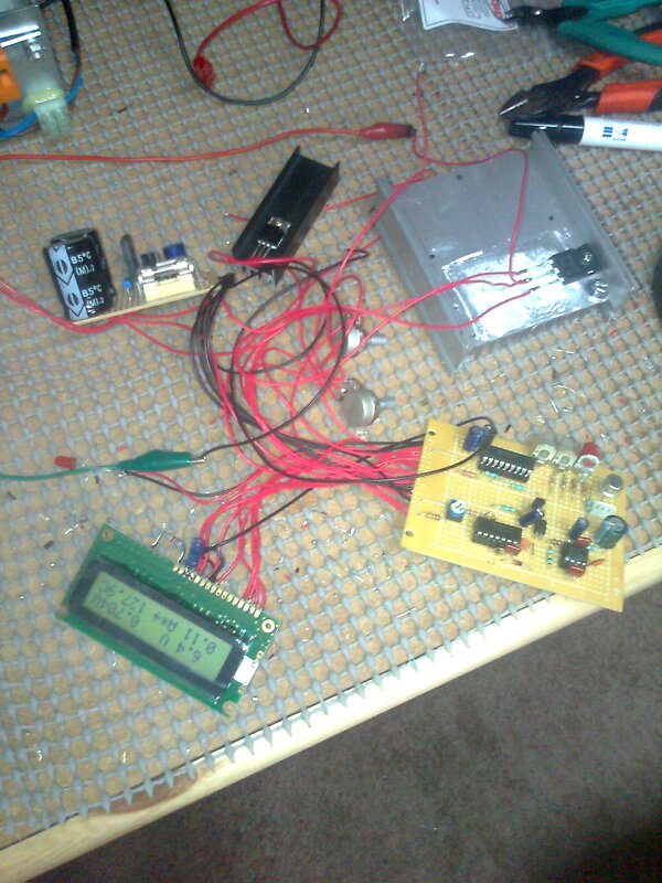

Well during the holidays I have built some more of the supply, I now need to do a duplicate for the other side.

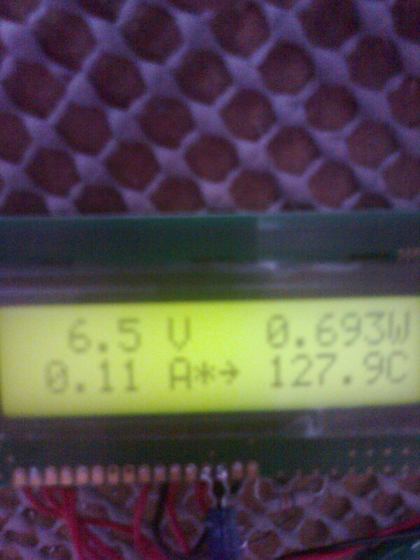

Of course I ended up putting a pic on it, to display volts, current, watts and heatsink temp, it also controls the fan via the temp sensor ds18b20, which is not connected in the pic, hence 127 degrees.
