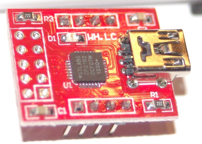

The Prolific adapters are available on ebay in several configurations. Here's a picture of the module that's my current favorite. Search for "Mini USB To TTL / COM Converter Module build-in CP2102" sold by szdigitalsquare. The module is almost cheaper than the parts and brings out all of the serial handshake lines and 5 and 3.3 volt power. They're going for $6.49 at the moment.
The USB signals are also available on header pins if you want to use a different connector.
The board is 1" x 0.8"

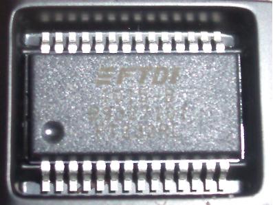

These are nice I just wish you could get them in p-dip FTDI usb-rs232 chip

Burt why not just buy one and place on SSOP/SOIC to DIP ?
The Prolific module is only offered as an alternative. Since none of the USB converters are offered in a DIP package, it's convenient for somebody who doesn't want to deal with small SMT parts. The cost for the module is $6.50 including shipping. At Digikey, it looks like FTDI chips in the 1 quantity are $4.50.

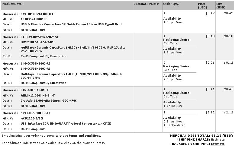

For the MCP2200 its just over $2 which is nice also. Cheap as heck...
Take a look at this picture. Everything needed to have a running converter... including USB connector..

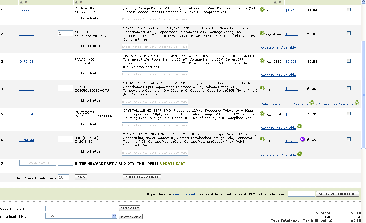

Atom: how about even less?
$3.10
BTW, d'you think I can stack a pair of .22uf caps, giving .44uf rather than the .47uf cap, and it will work ok? Kinda have the .22's in stock.
Same with the 470ohm resistors...I have some 270's in stock that ought to work ok. as LED dropping resistors.
