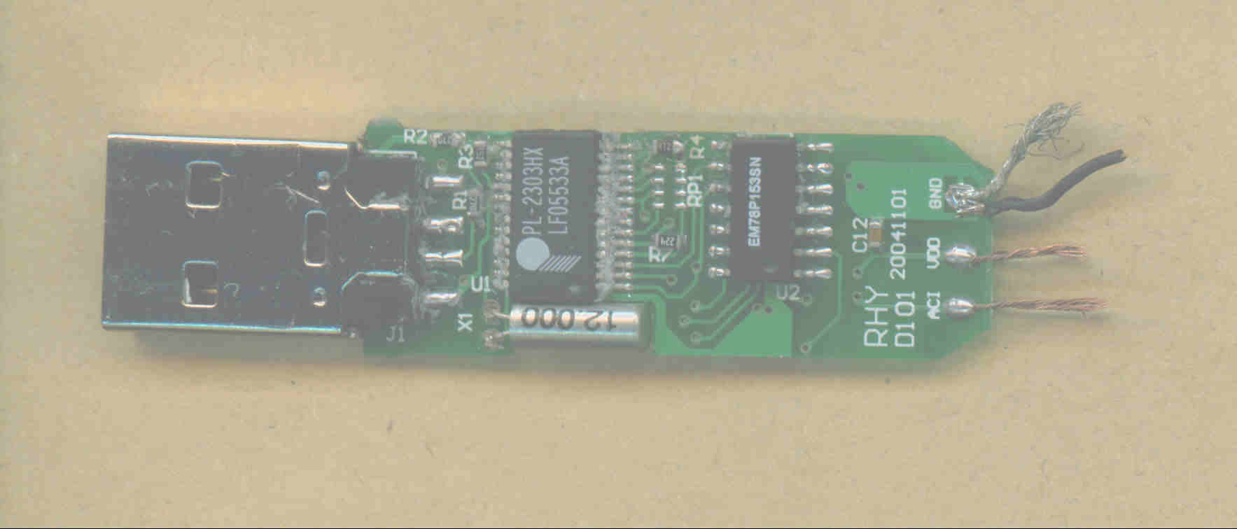

So I bit the bullet, and tore the case from the usb connector, the soft rubber outer came off quite easily, but underneath that, the entire board was coated in a soft moulded thermo plastic. It wasn’t too difficult to peel the plastic from the pcb, the results are shown, there is still plastic around the pins of the pl-2303.
The pcb uses a PL-2303HX which is 3.3v max, but has a 5v tolerant RX input, the second ic is an em78p153sn which is a 14pin 8bit micro. The whole thing looks quite well made, and looking at the bottom of the pcb, is also used as a charger when the missing components are added. The microcontroller appears to monitor/control the charger circuit as well as some of the serial data lines.
The rx data line has a 4.7k inline resistor and a 220k pullup at the pl-2303.
The tx has a 100ohm inline resistor.
Some pics
Oh nice! Looks more complicated than mine. I notice theres only one 'data' wire, perhaps thats the bidirectional line some mobiles use. Hopefully I'll post a pic of the guts of my CA-42 tonight.

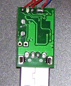

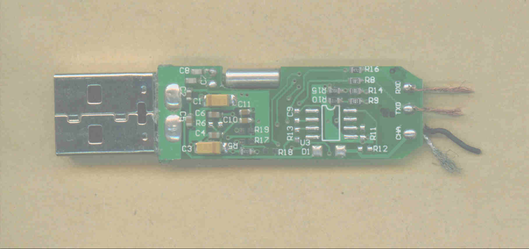

Update. Heres front and back of my CA-42 ($0.99 with free shipping from ebay). Stupidly basic,and pity they epoxied the chip eh?

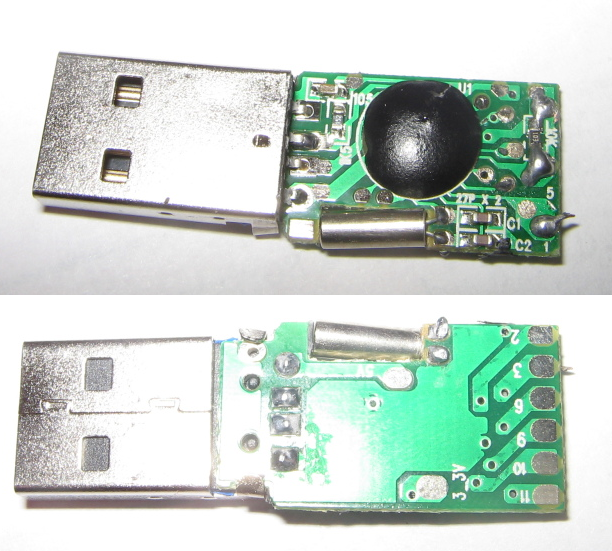

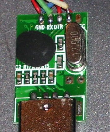

The cables are completely molded so there's no easy way to get at the PL-2303 circuit board but if you decide to cut through the blue plastic and then the black plastic potting underneath you'll find the circuit board shown in the pictures below with relatively easy access to solder pads for the 5v, 3.3v, and other serial signals, like DTR.
In summary, it seems I can have a "pretty" molded $2.68 usb-to-serial cable with just Rx, Tx, and Gnd, wired to a 3.5mm Stereo type plug for my projects, or, I can have an "ugly" adapter without molded USB shell on one end but with access to 5v (<100-ma), 3.3v (<50-ma), and several other serial signals.

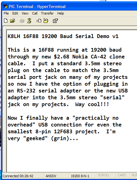

My 16F88 Serial Bootloader now working as a USB serial bootloader... Oh yeah!!!
ca-42-16f88-bootlo-png.41608
