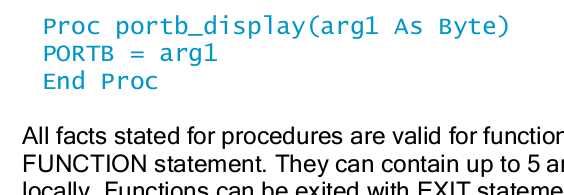

Hi M,
I'm no programmer, but could the problem be:
proc putFifo(dat as byte)
I've never seen and extra word such as 'dat' before.
C
Hi M,
C
From the manual,
on page 10.
