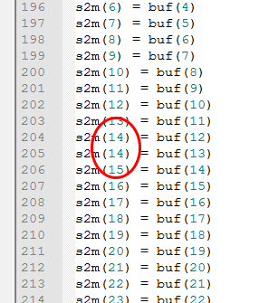

In #44 and the GPS CODE under '-------- PARSE UTILITIES -------------------------
I had a quick look at that today and it seems very inefficient,
Is this a mistake or bug?
I was thinking this should be a for next loop but then noticed there's two difference at the beginning but only one at the end due to s2m(14) being used twice. If it's not a mistake then just remove the line, s2m(14) = buf(12) as it's not required. BTW, what is that code doing?
Hi M,
From memory, there was a 'for and next' loop, but I couldn't visualise it, so I left it as you see.
Also from memory, I think I changed the BUFFER to be simply S2M.
It's just the poor way I work.
I saw those errors a while back and changed them, once I saw the 'live' sentence, with mistakes.
If possible, ignore it for now, and I will distil it later.

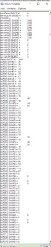

Hi M,
Look for <<<<<<<<<< lines.
This is what I'm getting on the terminal screen from the SEROUT
C

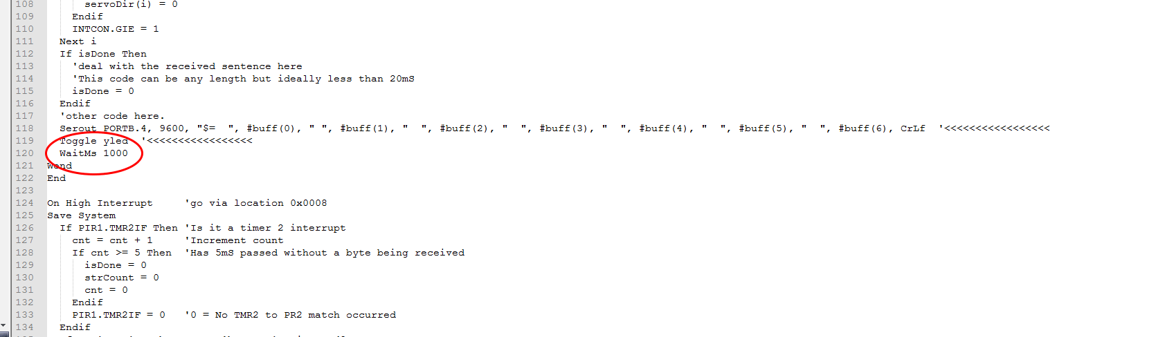

What is this nonsense?
We have nice fast interrupt driven code and then just throw a one second (yes one whole second) delay in and introduce something called "Define SEROUT_DELAYUS = 1000" = another random delay. And after a comment saying "This code can be any length but ideally less than 20mS".
I hate any kind of delay and any compiler that relies on them or that has them built in should be thrown in the bin.
Hi M,
Ah yes, that's just a test indicator for me, the results are the same without it, only faster.
The "Define SEROUT_DELAYUS = 1000" line is commented out, and only there because I found it when trying to get the CODE to work, as a reminder.

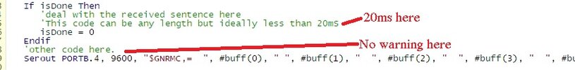

Hi M,
Can you calrify, where any long CODE, will go please.
I follow any instructions, but they must be clear.
Looking at your 20ms warning, to me it looks like that warning doesn't apply to the section where I added the SEROUT and the now removed WAIT, but it may seem obvious to anyone else.
C
I'm guessing that the line,
Serout PORTB.4, 9600, "$= ", etc.
Is a software serial function that outputs at 9600 baud on B4.
A function can be added to the ISR to make this happen.
I think this will output data at 9600 baud on B4.

Hi M,
Moved the START UPS
NMEA sentence from B4 at 9600
OUTPUT 'reserved word' now OUTPT
No sign of life, only the LED.
C
Hi M,
NOTE: The $NMEA sentence is only used for visual testing, so won't be used normally.
You didn't answer where I can program tests, which may be quite large.
I don't have your skills, so if possible would like a MAIN-LOOP for me to play in.
C

To get any output on B4 you need to load outBuff with a string to send and gosub send to start everything.
You can have 10 second waits but the servos will pause for 10 seconds, not because the output has stopped but because the code that sets their position has stopped. Everything (except moving the servos) is happening on interrupts at the moment. If you need to see an LED flashing then use a variable to count to 25 before toggling it and it'll flash at 1Hz due to the loop taking 20mS to execute.
When I said, Can you show your code? I meant the code that builds a string and calls send.
Hi M,
Do you mean 'live' or SIM?1
In SIM, the NMEA sentence is copied from an example and pasted into the 'HARDWARE SIMULATION INTERFACE.
Live, as mentioned I use a 'live' GPS input.
Regarding 1 second WAIT, this would be temporary, to check something is happening, then removed, so 'live' I would see the SERVOs acting oddly.
C
It can be either live or sim but to transmit anything on B4 requires a string being built and a call to send. If this isn't done then we won't know it the transmit is working or not. Can we do this?
Hi M,
Yes, I'll try anything, EDIT: I'm pretty sure the reason it's already working, is that Oshonsoft software programmed it to.
Here's what I see in the SIM at the moment, with copy and paste into UART interface :
C
