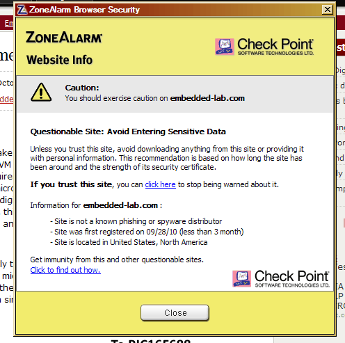

hi Raj,
My PC security software is warning me, that the site on that link is 'highly suspicious' and I should unlink from it.
