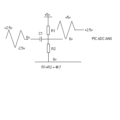

I suggest you look at the other similar thread, you simply bias the PIC input to 2.5V with two resistors, and AC couple the signal to the input through a capacitor. This DC shifts the AC signal to 2.5V - but you still mustn't allow the signal to exceed 5V p-p.

Look at the gif.
If you drive it with +/-2.5Vac direct from a signal generator, you will have to goto the shop and buy another PIC:rolleyes:

Oh meaning that
the PIC may be damaged if input voltage is larger than 5 volts or smaller than 0 volts. So with that circuit it actually maintains the analogue signal voltage to a range of 0-5v... Is it correct?
so if i were to do an ADC converter with a really big analogue input range.. how would the circuit be..? surely more components has to be used in that circuit you have drawn for me before connecting to the pin RA0 .
i appreciate your time for drawing the circuit for me! thanks ERIC!
You simply attenuate the incoming signal to within the +/-2.5V range - just as a multimeter or scope does - so basically just another two resistors as a potential divider on the input.
derrick826 said:
Oh meaning that
ONLY with a Vinput of <= +/-2.5V swing
