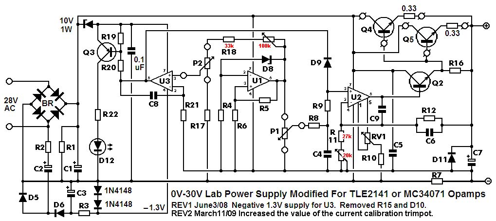

I have a PSU I'm wanting to put a LCD Voltmeter and Ammerter.
The out put is 30V and 3A. It has a load sensing resistor as part of its design as it has current limiting circuitry. The Resistor is a 0.47Ohm. Therefore the voltage across it is 1.41V (give or take) at 3Amps.
I'm wanting a resolution of 0.1V and 0.005A.

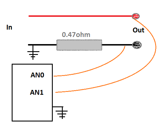

To work out the Voltage side, I will have to read AN0 and subtract AN1 to get the "true" voltage excluding the voltage over the sensing resistor.
I'm worried a bit about the resolution, as its will only give me a 0.1V, and due to having to work it out as stated above, I'm thinking I should maybe use something with a 12bit to get a better resolution?

Sorry, its a variable voltage, 0V - 25/30V (Just need to confirm ripple voltage and full load, but more than likely 25V or 26V), and variable current 0.002 to 3 amp.
Should have pointed that out.
I have attached the schem of the circuit. Thanks for all the help!

Downloaded your schematic, will look it over.
I assume that R7 is the 0.47R current sense resistor.

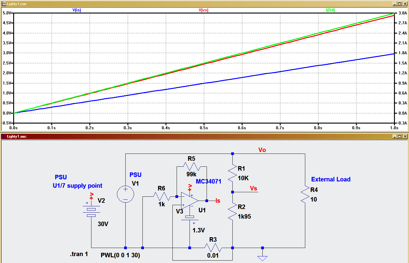

This is one option.
Note the 0.01R and the MC34071 OPA type.
If you could fit a low power +12V regulator inside the original PSU, you could use that to power the OPA. In that case you could use a LM358 or a CA3140.
The -1.3V is from the internal PSU's -V rail.

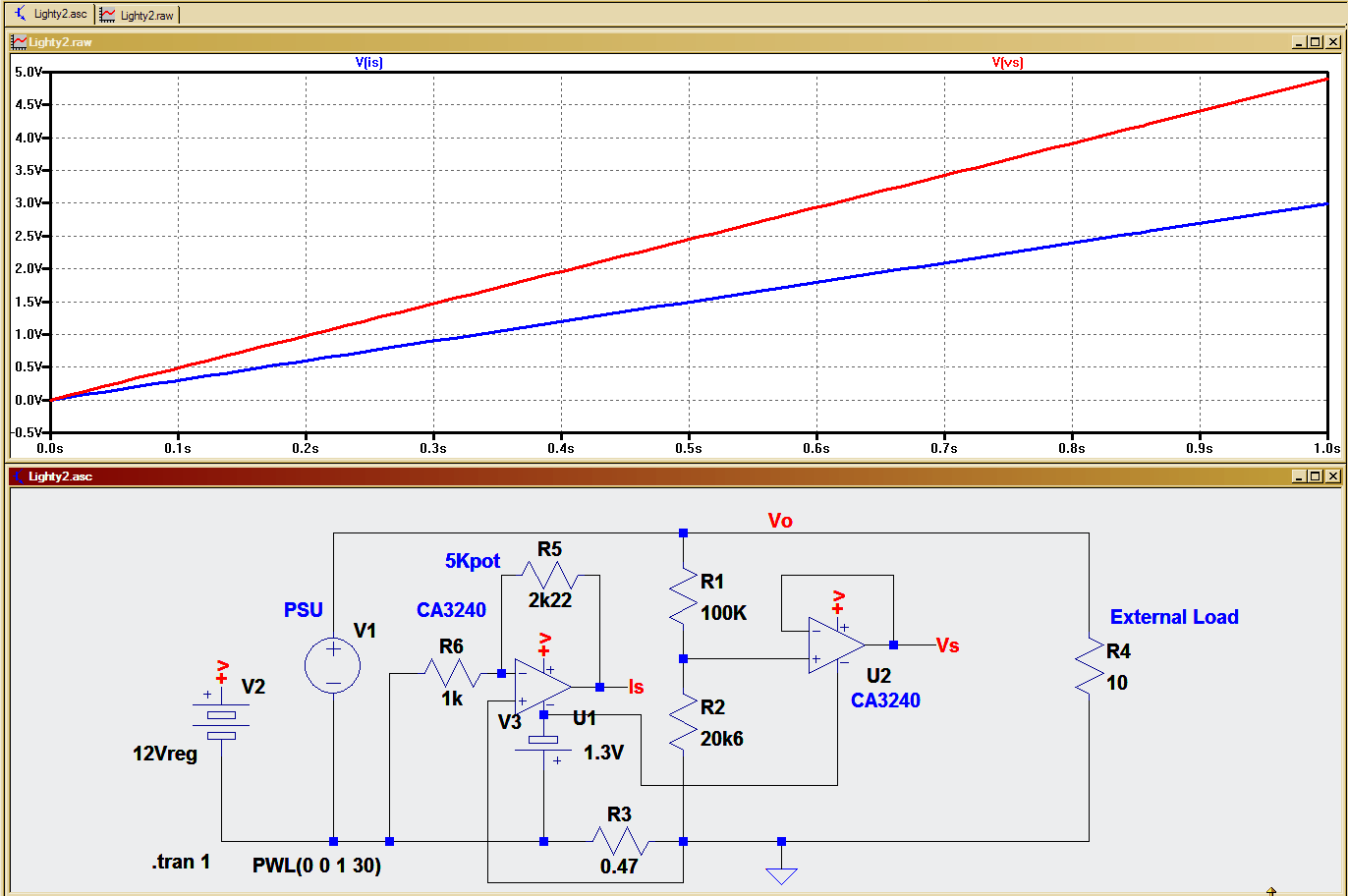

EDIT:
The 0.47R is R7
The plot shows the Vout from 0v to +30V with a 10R load
Ok. Lets see if I have this right.
R3 will be another Isense resistor, for the "display unit"
U1 will be used to amplify the voltage from the Isense resistor, outout to ADC.
R1/2 acts as the voltage divider from the output, driving U2 acting as a buffer to the ADC.
bit confused about 1.3V referance that is fed into U1/2
