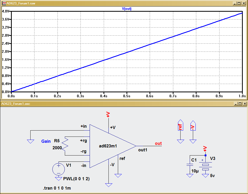

Have you grounded [0v] pin 5 REF.??
Post your circuit diagram.
EDIT:
Try it like this.

You must not have the two inputs floating, there must be a ground reference, it can be a high value resistor.
Connect the inputs as shown in my previous post, you may need to swap over the -in and +in.

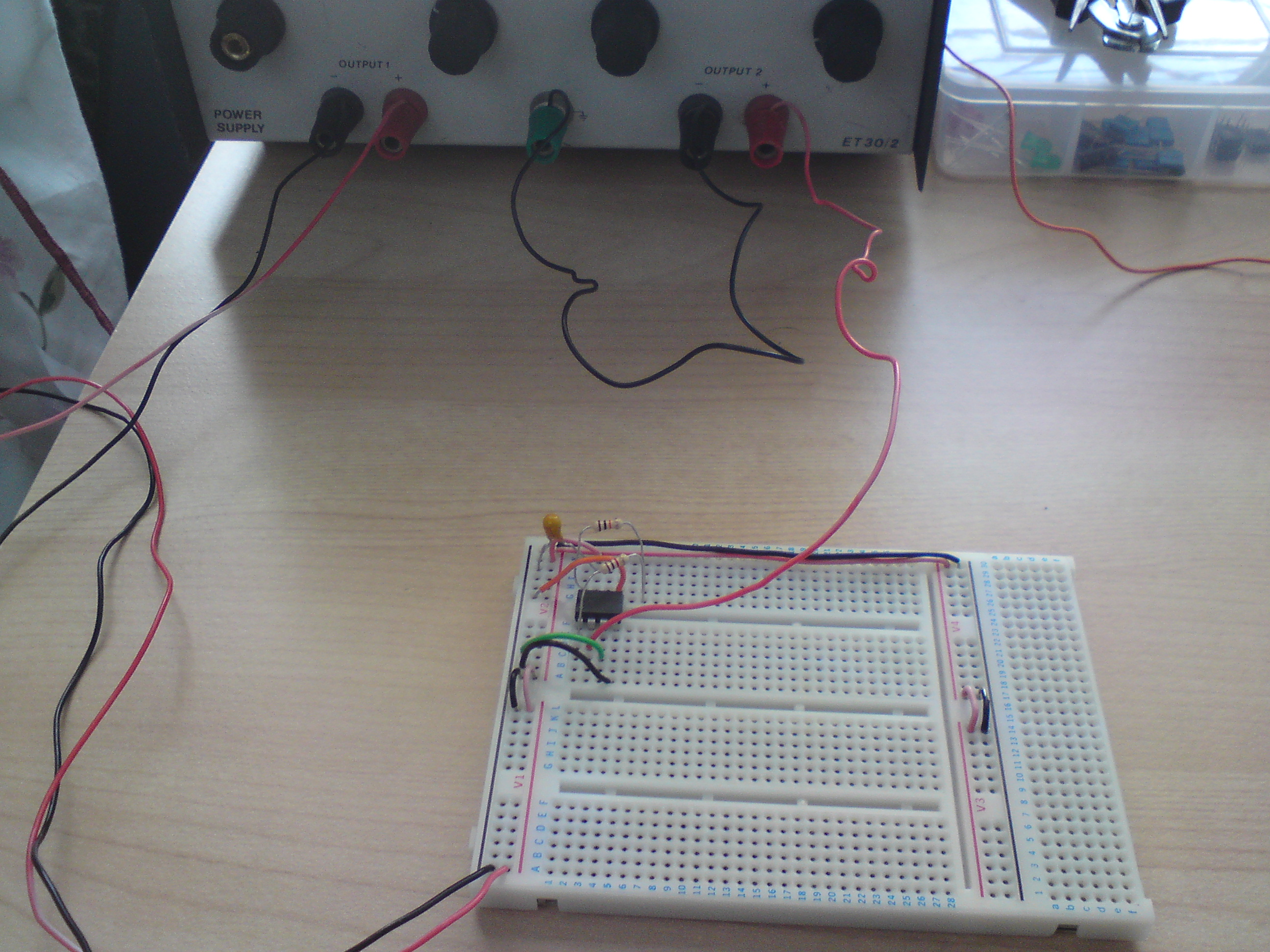

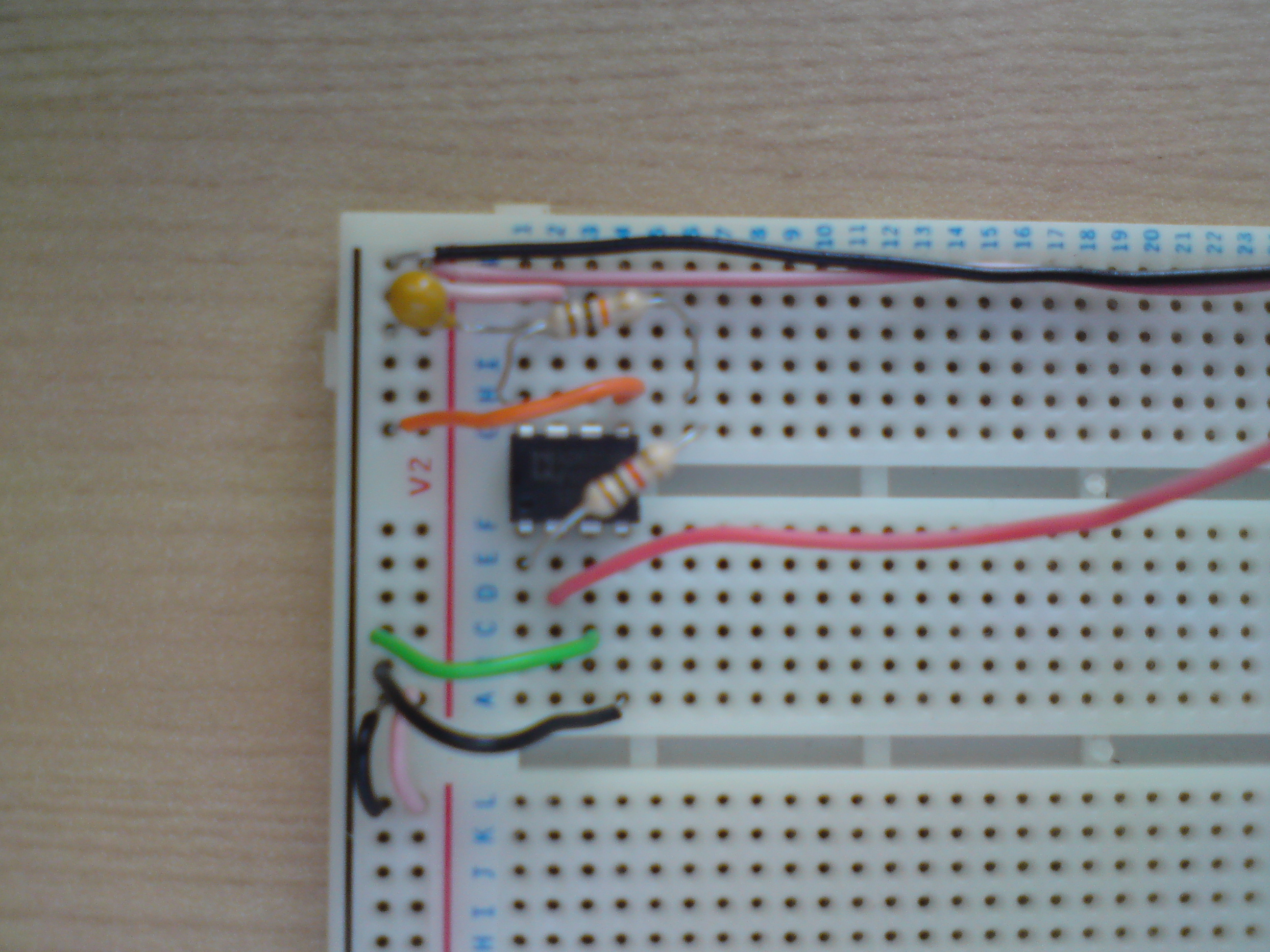

Picture DSC00132
-the 2 resistors are 1k each in series
-yellow 10uF capacitor
-orange wire is REF leading to ground
-green wire is +IN leading to ground
-red wire going out of the pic is leading to output 2
Output 1 are the power supplies to the amp
Output 2 RED is the supply to the -IN pin
Output 2 BLACK is connected to ground GREEN
thanks

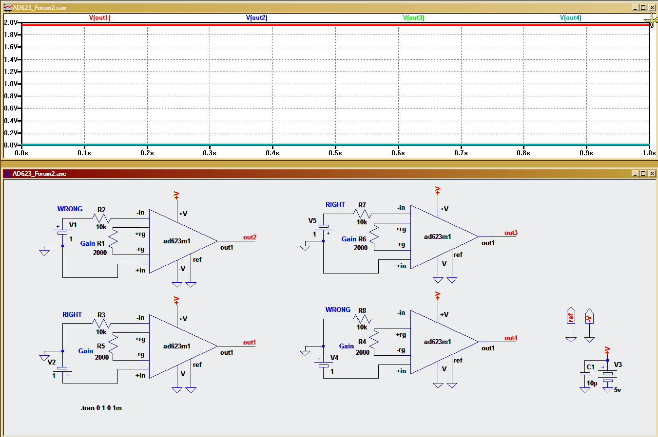

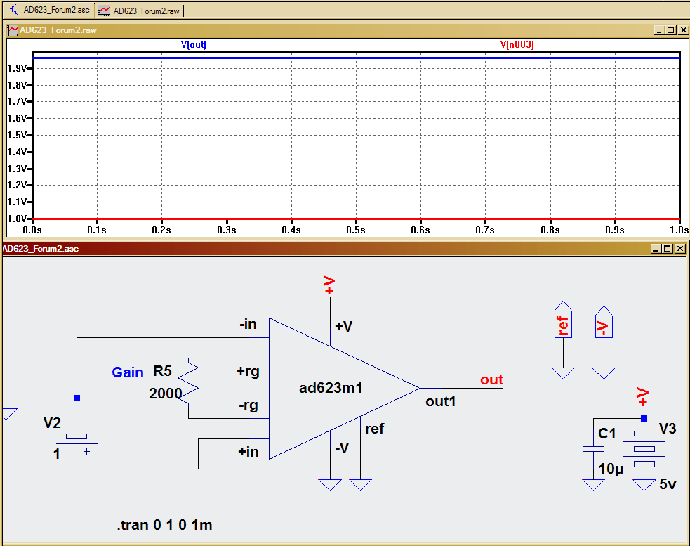

Connect the INV input to 0V and the NON INV to +1V, the other way around to what you have.
Be careful not to turn the V2 test voltage too high, say less than +2V, you really should have a 10K resistor in series with the +V from V2 in order to protect the AD623 inputs.
Measure the AD623 output on pin 6.
EDIT,
the way that you had it connected, when only using a single +5V supply, is the +Vinput on the INV pin2 is trying to drive the AD623 output below 0V, which it cannot with a single supply.
Thats why you must use a positive voltage, say 1v on the NON INV pin2, do that the AD623 output goes positive.

i think it works, but sometimes dont get the correct results from the output pin 6.
2kohms should give you a gain of ~50. When i applied 0.25V to the input pins the reading showed ~1.75V, it should be about 12.5V.
however, i changed the 2k back to 100k to produce a gain of 2 and i got the correct results but not accurately.
