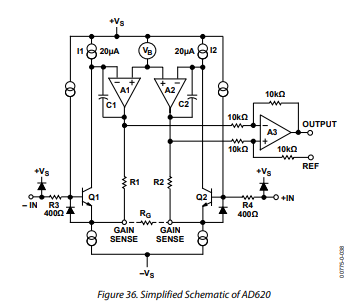

This got out of hand so I had to ask here. I am aware I am being to dependent on this forum and it is not something I enjoy. I tried solving this problem multiple times with different approaches and failed.
The problem is no matter how much gain I apply and how I filter the signal I can not get anything identifiable that looks like a hear beat on the oscilloscope. Even in the highest sensitivity which is something like 10mV, it is just flat noise with no ECG like component when I connect the props to my arms and leg. I started with AD620 datasheet circuit
And went to something as simple as this after nothing I did work.
When bottom circuit is tested with a signal generator I can see that It works and I have about 500 times gain. I put a low pass filter to output to set 3db point about 50Hz. Even if I amplify the output 100 times more to a total 5000 with 2 more op amp stages I get nothing. I tried 3 different breadboards, different ICs and checked the connections to props and confirmed that cables weren't open or broken in places. Even with the simplest circuit I should see some fluctuations in voltage with that much gain but instead I usually get 50Hz line noise or something that is about 5-10Hz that is not a heartbeat. Using the top circuit causes op amp to saturate and hit one of the rails even though "ground" is set to the body. Nothing I tried works. At this point I believe the connections are not working because we are not using the cream thing that is supposed to be used with securing the connection to skin.
I can not proceed with the project without getting any signal. Any ideas what may be holding me back.

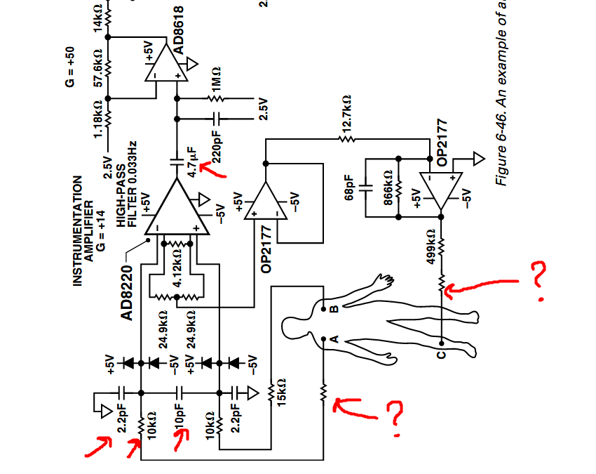

I think it is something to do with the electrodes. As you said when two inputs are tied together it is around 0V so there is not much off set from the amplifier itself. But when I touch the electrodes off set appears. I do not have the proper gel for them but maybe I should try different substances as rjenkinsgb said. I have some quality shielded audio cable maybe I should use it for electrode connections. I doubt it would help since I was using very short cables to begin with. I will try setting the gain to 1000 and see what it does. It is achieved with 50 ohm Rgain resistor it seems.
With some water based skin cream on electrodes I was able to get some pulses about 1Hz that looks like what I wanted but it quickly went to positive rail as usual later. Switching the connections of left and right hand caused it to go negative. So there is indeed a voltage build up on electrodes that is causing the amplifier to saturate. I tried shorting the inputs for a while in hope that maybe the potantial difference would settle out but as soon as I separate them voltage goes to rails. It is not caused by the of set of the device but the electrodes. I wish I could just use bypass capacitors to filter it out.

The circuit from the datasheet shows the opamp that is not powered.
What does that mean? That op amp also needs to be powered and it is just not shown on the schematic right? I used TL072 to replace it and use the second op amp for second gain stage in my first try.

Circuit was the second one from the first post. Plus and minus supply were 9V batteries. Oscilloscope was also being powered from separate batteries. I was sitting on plastic chair and was not touching the ground when trying it out. So I can say everything were separated from ground and each other. Probes were on arms and leg. I also tried touching croc wires directly over my heart as shown on the schematic. Lack of proper electrodes may be the problem but I think that simple circuit may be simply not cutting it. I need to build the first one. I think adding DC blocking after it with lower gain to not saturate to rails then getting additional gain can solve the issue.

Circuit on there seems interesting.
I am not sure how those values are determined but I think I need low gain at the diff amp and that 4.7uF cap and 1Meg resistor for 0.03Hz high pass filter then amplify it about 100-150 times like the first circuit at the first post. Are those diodes regular silicon ones limiting the input voltage to +-0.7V. It then centers the signal around 2.5V for the ADC since it only works with positive voltages up to 5V which is excellent since Arduino is the same. There is like 5 order filter after it to filter anything more than 160Hz but I think that is bit extreme for my purpose. Not sure how the leg drive op amp gain is determined though. Maybe I should just solder everything if that will make it work better.
