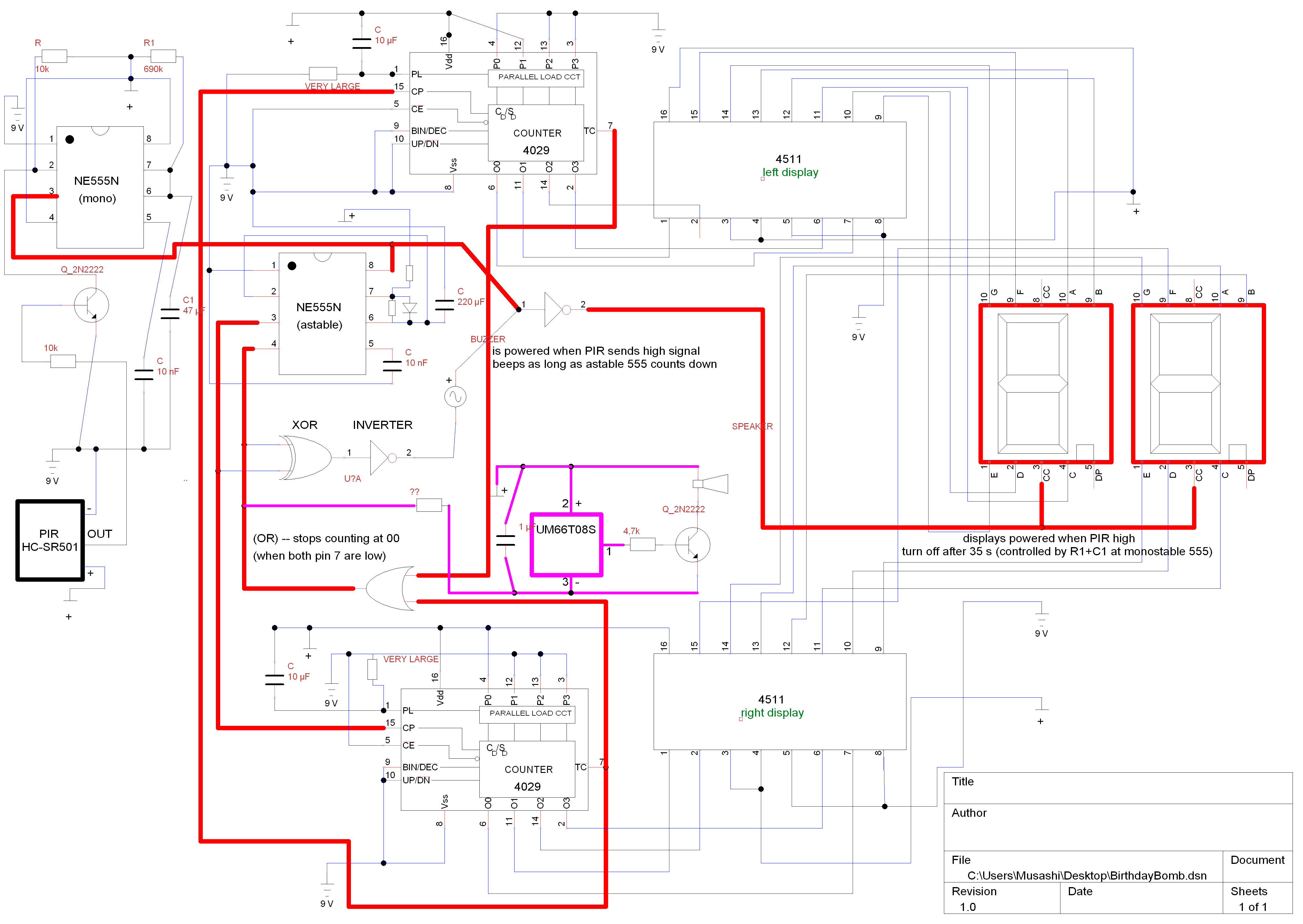

Your hint using a monostable 555 timer and a NPN-transistor worked to power the second astable 555 timer - thanks to all of you for your help.
My project contains building a birthday bomb (dummy), which is activated by a PIR-sensor. It counts down from a specified value (21 in my case). When "00" is reached the counting stops and a birthday music is activated (by using a UM66T08S semiconductor and a speaker). The part with the music/speaker is not implemented yet in reality (but purple at the circuit diagram) - I am still waiting for the UM66T08S to be delivered.
Furthermore finally a little motor will be triggered at the end of the countdown, which releases a little rod on a spring. At the rod a little flag with "Happy Birthday" or something like that will be written. In general, the triggering of the motor should work in the same way as discussed in this thread I think (transistor + monostable 555). The attached circuit diagram does not contain the part with the motor, yet.
At last I apologize for the poor circuit layout - it is still under development and this is my first project :). I marked the "important" (in my opinion) wires red. It was created with TinyCAD.

How long are you expecting the PIR, once triggered, to stay "on" before turning "off"?
How are you expecting the circuit to respond to a second, unexpected PIR pulse before the remainder of the circuit has completed the count-down?
The PIR itself is active as long as the battery is connected. With C1 and R1 (at the monostable 555 timer) the duration is set to power the whole circuit. In my configuration (47 µF, 690k Ohm) the circuit is powered for 35 seconds.
A second, unexpected PIR pulse during this time has no effect.
When the counter reaches "00" the reset pin 4 of the astable 555 timer is set permanently low. Therefore, a second PIR pulse after the counter reached "00" has no real effect, because the circuit is unable to count down in this state. Only the seven segment displays are powered again and show 00 for again 35 seconds (which is not really desireable I must admit :) ).
To avoid powering of the seven segment displays at the final state I must modify the powering of the displays slightly, thank you.
