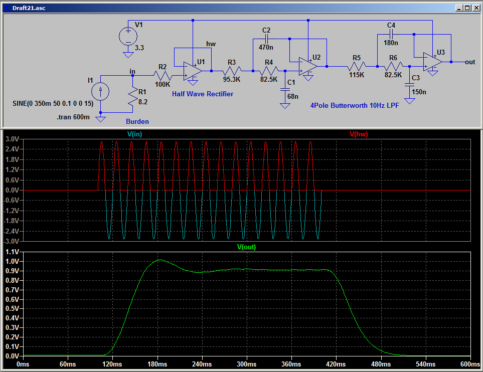

The input is 350mA RMS and is loaded with a 10 ohms resistor. The resistor is used as a "burden" which is the resistor used in a current meter and the circuit in this thread detects and measures the voltage across this resistor then calculates the current.
The TS has some stringent requirements. Here is a hack using a 4pole Butterworth 10Hz LPF following a half-wave rectifier. Note I adjusted the burden resistor to prevent V(in) clipping.
Note the settling times of V(out). Note the residual ripple, which could be reduced by using a full-wave rectifier. Conversely, using FW, you might get by with a 2-pole LPF.

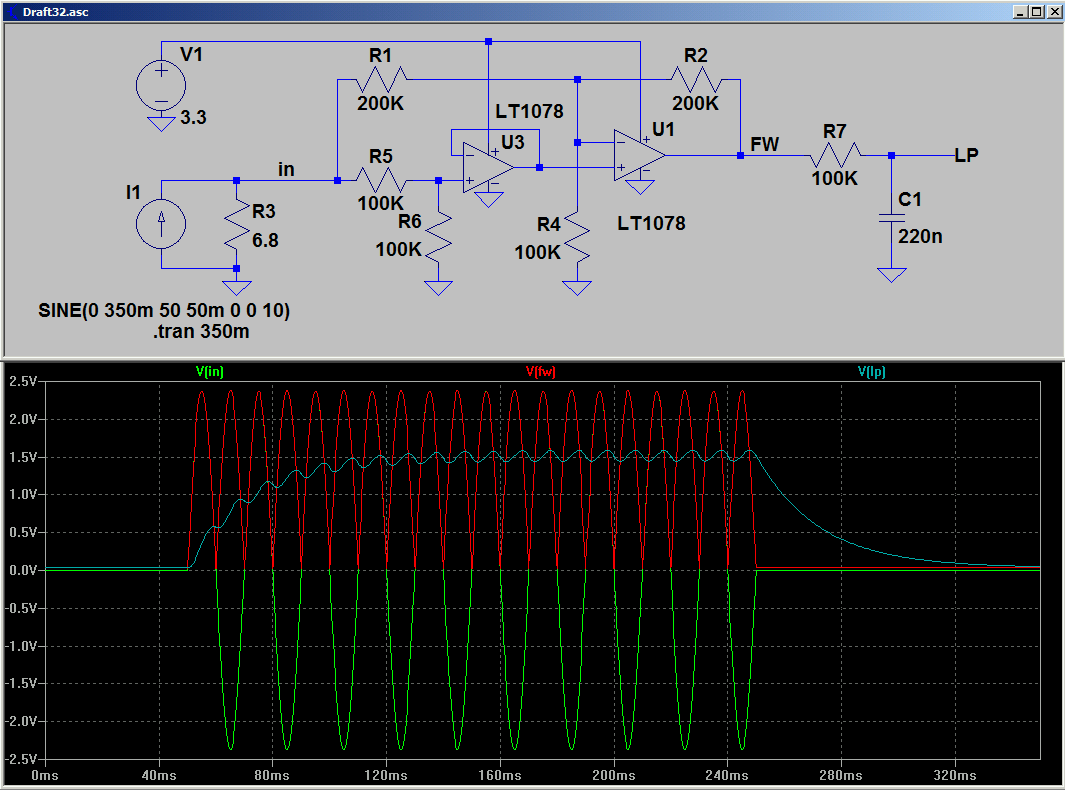

Here is why you cannot do this with a single pole filter with such a short rise-time, even starting with full-wave rectification. Note the residual ripple at V(lp)
You can play around with various more agressive active Low-Pass opamp filters here.

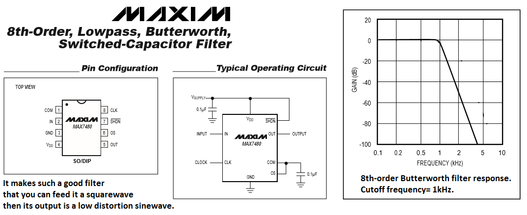

Why not use a modern multi-order switched capacitor Butterworth lowpass filter instead of capacitors, resistors and opamps. It makes an excellent filter.
Years ago I used switched capacitor filters made by National Semi but they are not made anymore. Here is a Maxim one:
Unfortunately that Maxim filter IC needs a 4.5V-5.5V supply. The TS has a 3.3V supply.

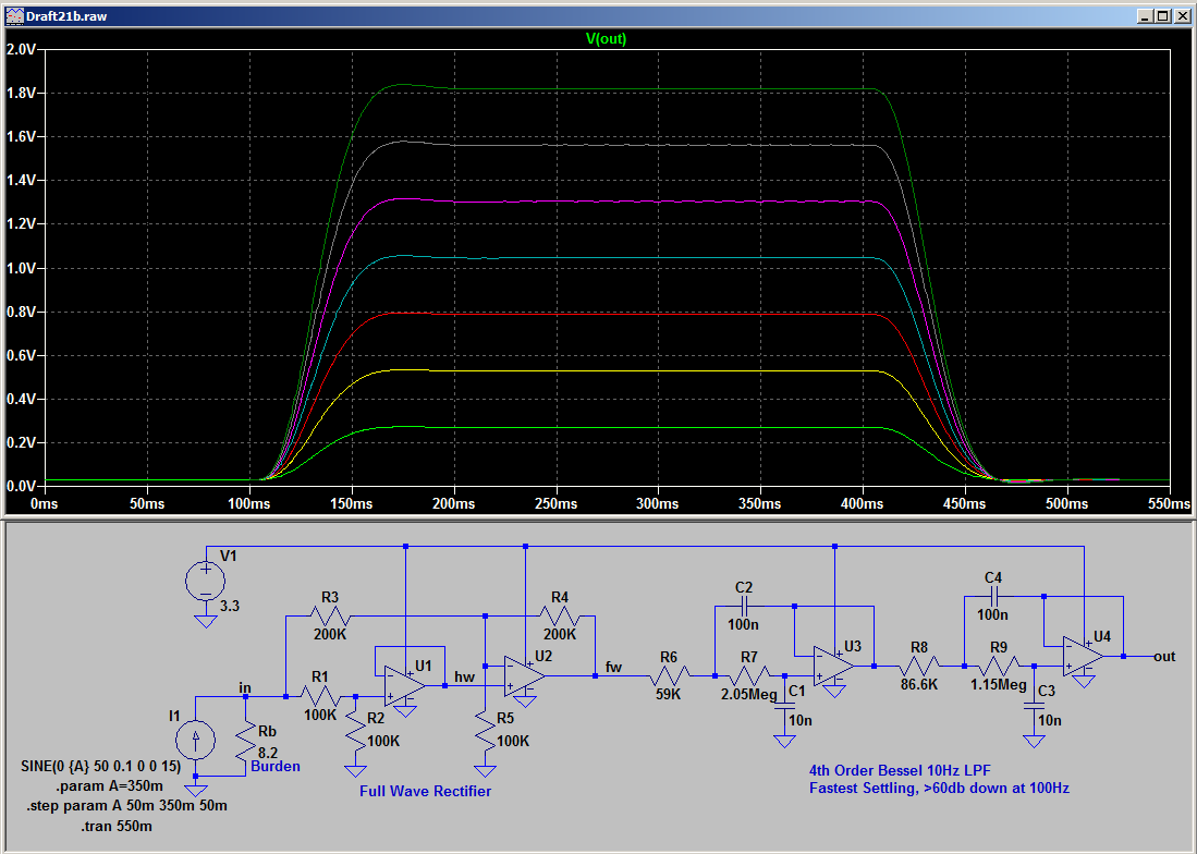

So here is my final attempt. The Input I(Rb) is a 50Hz sinusoidal current burst (15 pulses) that starts at 100ms and ends at 400ms. The simultion is repeated with the amplitude of I1 stepping from +-50mA to+-350mA in steps of 50mA.
The current is converted to a voltage by the burden resistor Rb. U1 and U2 are a full-wave rectifier that creates the full-wave rectified signal at V(fw). The average value this signal is proportional to the input current, but has its first ripple component at 100Hz.
We need a filter U3 U4 that smooths V(fw) to get rid of the 100Hz ripple, but settles within 100ms. It takes a 4th Order Bessel LPF to do that.
You need Rail-to-Rail IN/OUT 1MHz 3.3V opamps to pull this off.
I would like to see you repeat this simulation in Multisim, including the filter rise-fall response. I think that LTSpice is far superior to Multisim in setting up a complex analysis like this. Note how easy it is to start-stop the sinusoidal current, and to repeat the sim at multiple amplitudes. For the students of LTSpice, I am including the .asc file so you can run this sim.

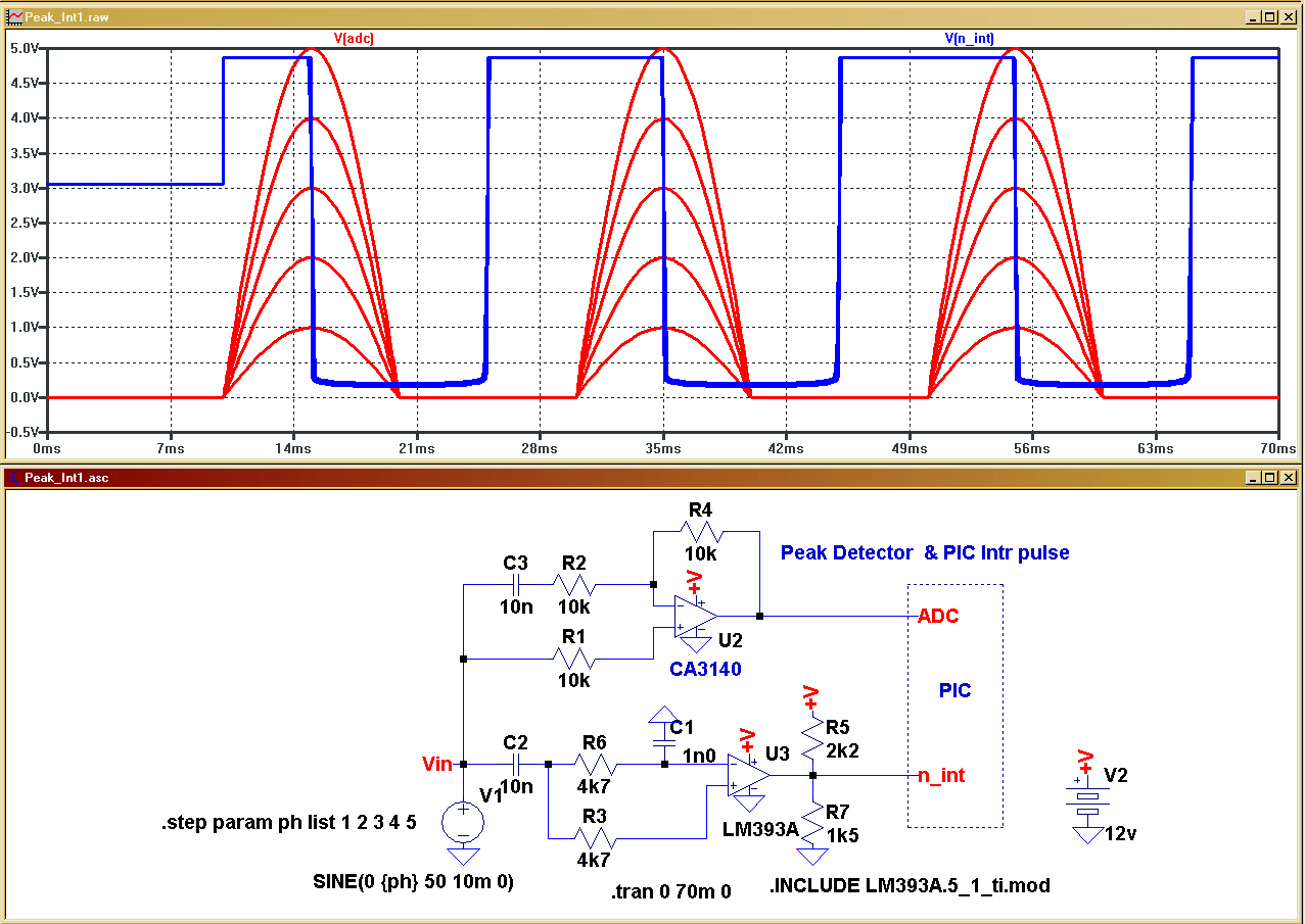

If the use of a MCU/PIC controller is allowed, this option has a sinusoidal peak detector and a MCU interrupt pulse generator, which occurs at the peak voltage.
The MCU could be programmed to read/save the ADC, On Interrupt, the peak value, if the peak exceeds to set level for more than 200mSec, a MCU output alarm pin is set High.
The test Sine wave input is set for 1v thru 5v

I am not getting a smooth dc after doing this...Can you suggest resistor value?
You need to use the circuit Mike showed in post #30.
Anything less will not meet your criteria for both rise-time and smooth dc.

Thanks a lot Sir...This circuit is perfect.It has fulfilled my requirement
