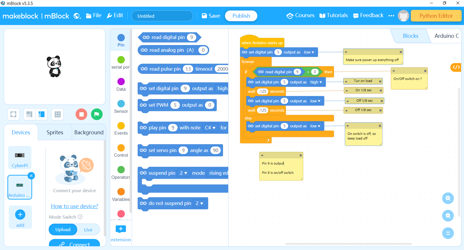

Here is approach using block language (mBlock) to program an Arduino Nano board :
You drag and drop blocks into right hand window, config their parameters, like pin number
or voltage test. It would be easy to measure with Nano board Vbatt and shut off operation
when Vbatt drops too much. If you want I will show you the change in blocks to do that.
I added on/off switch. Read the comments next to blocks to follow how its working.
mBlock converts your block structure to Arduino code and programs the board.
if you look at the code basically when Nano board starts up first thing done is to make
sure output is off. Then you see forever block which runs the code inside its arms in a
loop. Inside loop on/off switch tested to see if its on, if so the load is turn on, then off,
for 1/8 sec on the 1/8 off, and loop repeats. If on/off switch off force output off.

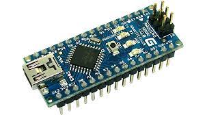

To handle the current use a Arduino type relay board, or MOSFET .
OR relay board -
They come in 1 - 8 channels depending on how many loads you want to switch.
The Nano can take up to 20V input from vehicle power. But beware use a "load dump" circuit
to protect everything. Load dump cause large transient voltages in a car.

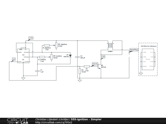

Please see my reply to audio guru. I really do appreciate everyone's help, and I like the schematic you posted for me. However I don't understand it. Will you please hand draw a schematic of this project as I described it to audio guru, labeling all of the parts in terms that I can understand (such as resistors of certain value, whatever a gate is, etc). This device only does one thing, so the schematic has to be really simple. If you do this for me it would be a HUGE favor. There are appropriate electric fence chargers for sale near me, but they're way too expensive. I'm on a fixed income and inflation is eating me up, so I figure a used ignition coil and some electronic components will be much cheaper so that I can afford it. Plus it'll be the first circuit I ever built and will be a lot of fun. I live way out in the sticks on two acres. This device will also allow me to raise chickens. Everybody up here uses fence chargers around their coops, or the bears would just rip the coops apart.
You need more than just an ignition coil and and on/off switch to make an electric fencer.
Do a search for "electric fence" on this site for starters.
I have just put one together using a auto ignition coil, typically a 555 timer is used, in my case I used a 8pin picmicro.
Mine is aimed at deer, one method is to use silver foil smeared with peanut butter on the live conductor wire, I am sure it would work the same for bears.
Those links might get you started. Once you home in on one ask forum for
any recommended changes to make design more robust.
Regards, Dana.
Added -
Nothing in the ignition coil circuits activates them. They are turned on all the time that the on/off switch is turned on. A motion detector circuit could be used to turn them on.
I used a 0.1 sec burst of pulses every second.
i.e. 1 second off between bursts.
BTW, 10kv is the maximum voltage per international rules.
That would mean the peak (flyback) primary voltage on a standard ignition coil should be limited to 100V.
