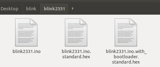

The arduino Ide does not keep the hex it loads not by default if it's 1.8.4
There was a button in tools it's been removed
If you hit the verify button it will make one and save it on my computer it's
/tmp/arduino_cache_463758/core/core_arduino_avr_uno_fc271d69264b640f540ae730d6ca5643.a
you find where here the red text
Ok a little looking around and the 1.8.4 has the button moved to Sketch Called
Export compiled Binary
If you make a folder on your desktop blink hit the Export compiled Binary
and then open your folder you should have what you need.
Like this
