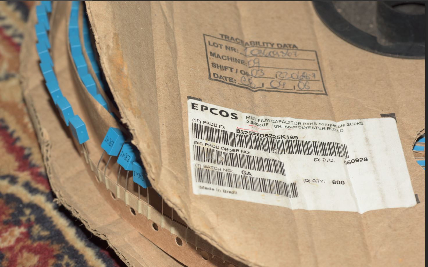

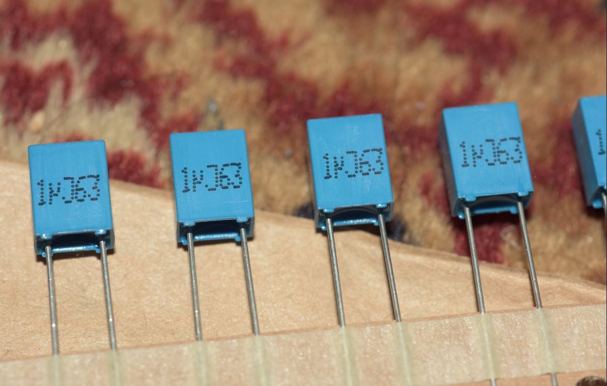

Ok found some more caps, I know I have loads more but havnt scratched the surface yet in sorting them out, have a look at these and if they are any good let me know, I can let you have 50 free except for postage at cost if you want them, I will be selling some the others (cheap) if anyone else wants any.
I will post more as I find them.
Hi LG,
Kind thought; while those caps, are high quality and suitable for general electronics, they are polyester (mylar), and not quite in the same class as polycarbs for hifi audio. They would be ok for general audio though and are not horrific sounding, like ceramic capacitors and many electrolytics.

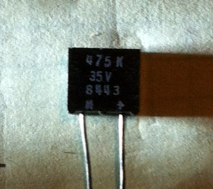

Hi Spec, and G'day. I found a lot of these caps (see image) in my parts bin. I know they are 4.7 uf caps, but not sure what type they are. There is a polarity marking on them, but they do not look like tantalum's or electrolytic. Do you know what type they are, or anyone else can chime in as well.
Hy Mike,
What are the dimensions? Are there any markings on the other side?
spec
~ 8x8x4 mm, no markings on other side. Thanks Spec.

I haven't found the exact type, but in view of the style and size I would guess 4.7 uF, 35V solid tantalum, probably made by Kemet, quite old too. If you are prepared to sacrifice one you can put 35V reverse across one in series with a 100R resistor. Keep well out of the way and be careful particularly about your eyes. If it is a tant it may explode or bulge, or emmit some gas. If nothing happens leave it connected for 24Hrs minimum and then check the cap value. If it is a tant I would expect it to be open circuit. Another test you can do is to put a 10K resistor and ammeter in series with the capacitor and connect around 35V, of the correct polarity, across the circuit. If the Ammeter reads any significant current the capacitor is an electrolytic, if not heat the capacitor to 100 deg C and check the current again. Any leakage current indicates that the capacitor is an electrolytic, probably tant. It is just possible that the capacitors are ceramic but they are too small really.

My scope has those in it, they are def tantalum! Dont reverse them they are like bombs :D, great fun though :D, and they are expensive!!
I appreciate your input and have seen exploding tantalums when I was a factory tech, came out of production that way. Was cool, but I am not sure I would suggest connecting backwards as a test because kids reading these forums may try it and end up getting hurt. The 24 Hr test is really a hazard, what if in hour 16 while you are asleep the cap decides to blow and causes a fire (I have seen PCB's catch fire from backwards tantalums). I guess as a guy who worked as a Safety person I am overly cautious. So I will throw in a disclaimer, folks don't try this at home.
Quite right Mike, but a touch dramatic- if kids or the less experience tried most of the things described on ETO, they would be in danger. Common sense is the key word. The other thing is that with a capacitor that size there would be no major explosion and the reason why, I said to place a resistor in series with the capacitor is to limit the current.
