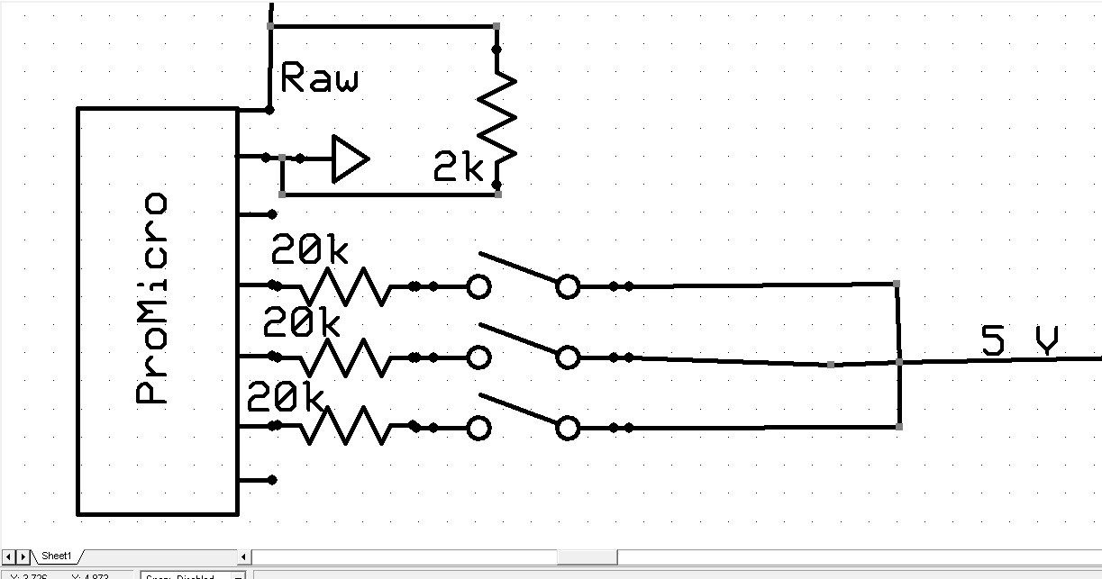

Should I expect the ProMicro to activate without supplying power to raw and any or all of A0, A1, A2 is set to high?
If so, is there a way to only power the ProMicro using the raw pin irregardless of whether or not A0, A1, and/or A2 is set high?
Your micro is being powered via the protection diodes on the input pins. To prevent this use 20k resistors in series with the 3 input signals and make sure there is some load across the supply - a 2k resistor will do.
Mike

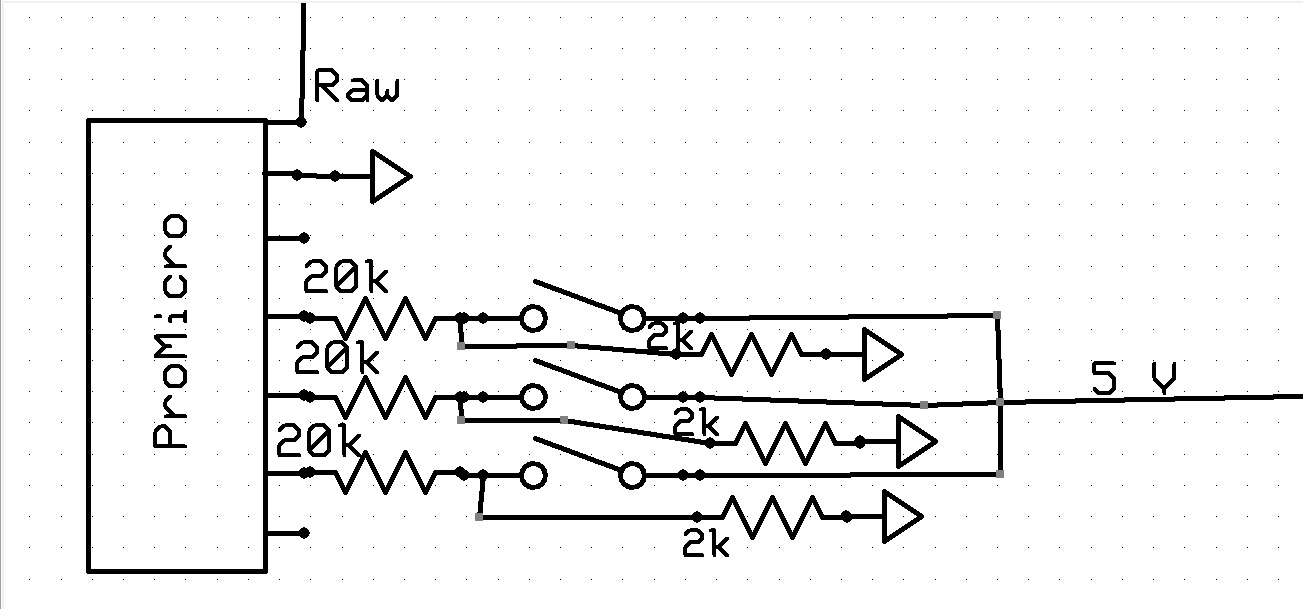

Thank you for the reply. Does this schematic follow your suggestion?
You don't need the 2ks to ground but do need something to "use" the tiny current supplied by the 20ks. An LED and resistor on the power lines would be ideal. If not one 2k resistor across the power lines will suffice.
Is this correct?
Am I correct in understanding the above circuit reduces the flow of current to a manageable level by use of the 20K resistors. If raw is at 0 volts and and a combination of switches are closed then the current allowed in the ProMicro goes through the protection diodes and is converted to heat in the 2K resistor; thereby, not allowing the ProMicro to activate?
That is correct. If all 3 switches are closed then it will form a voltage divider with a 4 to 1 ration (6.6k and 2k) and so the micro will only see 1.25V and will not turn on.
