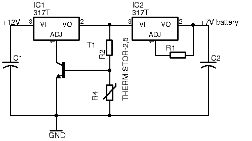

This is why I come here for ideas. But I did think of one. This circuit that I just thought of. Thermistor is attached to the battery to detect heat and when the battery is hot enough then transistor turns off which makes input to IC2 low so battery won't charge. When IC1 is on then IC2 goes on and provides constant current via R1.
I may have R2 and the thermistor switched up and maybe my input voltage is too low but am I sortof in the right direction? (I still think its a bit ridiculous to strap a thermistor to a battery while charging but if it has to be done then so be it.)

If you want to charge 4C, use the MAX713. The raw circuit is beyond you for the time being and there is no room for error and different methods of detecting end of charge are used that don't work for lower charge rates. These are circuits that have timers, sampling, memory of initial conditions, and calculate slopes. Use it with a big transistor and a big heatsink and fan.
I agree with dknguten. If you want fast charge, then you need a reliable, precise charge termination detection method. And, properly configured, the purpose built battery charge ICs will give you that.
The battery charge IC's use thermistors to look for a change in the rate of temperature rise, not an absolute level of temperature. In other words, at what point is the current into the battery no longer being converted to chemical energy, and is being converted to heat instead. That is the point when the battery is full. If you wait for the battery to reach a given temperature, like your circuit in post #21, you've probably already damaged the battery.
Look at any older power tool that uses fast-charging into NiCds. It has three terminals on the battery. Two terminals pass the charging current from charger to battery, while the third terminal is for the charger to sense the thermistor embedded inside the battery.
ok I found theres a max712 and a max713 IC for charging batteries and I think one is for detecting negative slope and the other for detecting positive slope. On futurelec.com, the prices of the two chips are $1 apart. Which chip is better to use?

I would not worry about efficiency. This is for a home-brew, one-off battery charger, not a cell phone. I think the complexity and cost of getting a switching regulator to work correctly far outweighs the little bit of heat saved. The LM317 is a power device; it can take the heat. When you have real numbers for the transformer-bridge-filter capacitor section, working out the heatsink required is simple math.
Schematics #1 and #3 are constant current circuits, which is the right place to start. Schematic #16 adds a form of fully-charged detection to back off the available energy and not overcharge (overstress) the battery chemistry, but is not constant current for the main charging cycle.
Note that Linear Tech, Maxim, and TI (formerly Unitrode) make chips designed specifically for "proper" charging of battery chemistries, if you want to go that route. If not ...
#21 is better, but not quite there. For semi-intelligent charging on the cheap, I like the two LM317's in series. The first is a standard constant-voltage regulator to set the maximum possible voltage across the battery when it is fully charged. The second is a constant current regulator to set the maximum possible current to the battery during the heavy part of the charging cycle. In your schematic, IC1 needs the two standard voltage-setting resistors, with the thermistor circuit added in parallel with the lower one. Depending on the thermistor, you might be able to simply place it in parallel with the shunt resistor, but that way might not have enough protection effect. That is, when the battery gets hot it might not turn down the output voltage enough.
