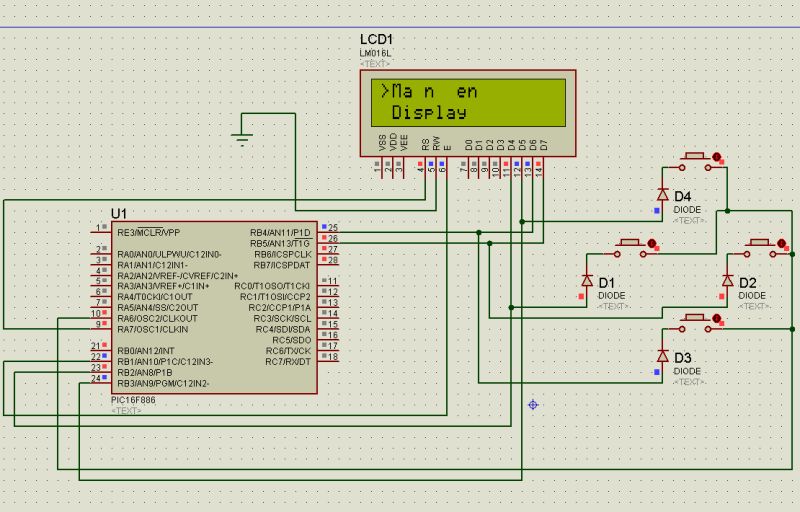

Can you post a normal schematic for me? Im working on LCD init right now since in Proteus its kinda retarded heh

What you have is correct and it looks like it is almost working. Maybe the delays are wrong. Try dropping the speed to 4MHz with osccon=0x61; Or, even 0x51.
Thanks for this.
Heh it was my fault actually i didnt set the OSC in Proteus lol ti was using 1mhz heh stupid Jason heh

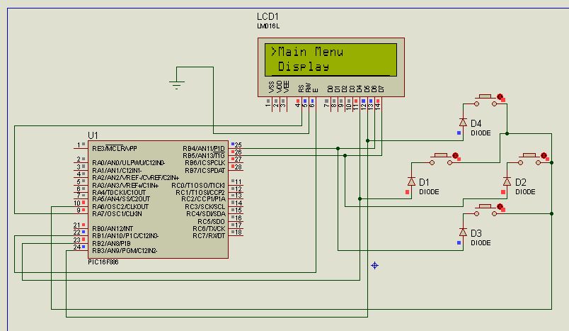

How do the button work? I have had much time to look through code but buttons confuse me here. They dont seem to work

From D4 to D7 are back, up, down, enter. So pressing the bottom button should move the > character down and pressing the rightmost button should enter that sub menu.
Edit, the top line "Main Menu" doesn't do anything, it is just a heading.
Edit2, as they are arranged your buttons are like a joystick, good choice.

It works fine with the real hardware, does Proteus handle the internal pullups correctly?
Haven't looked at the menu code, but aren't the diodes backwards in the schematic. Ra6 wouldn't be able to tell which button is pushed, unless it's analog input with associated button resistors or'd together.
Try changing the diodes for 10k resistors. Got to go to bed now but let me know how it goes.
Tried this and no good. I wish i understood your method heh
From what i can see... you are using a XOR to check the PORTB bits. I assume you are using this to check the current value and test it against a users press.
How do you know when a user presses a button. What happens when the user holds the button down then it will create a flag with the same bits to XOR and you will get no result.
I dont know lol can someone explain the way it works or supposed to in this case (my Proteus side)

I must have been tired last night. Changing the resistors to 10k was silly, they should be 1k.
I see what you mean now about leaving A6 as output. I've changed the code and commented it.

If it still doesn't work can you set a break point to see what is in keys when a key is pressed.
edit, maybe Proteus is taking pin capacitance into account. Try adding the line in red to see if it fixes it.
