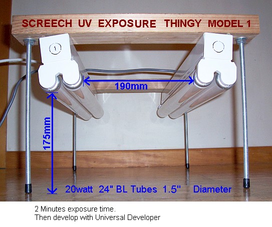

I'm looking at building a UV exposure box out of an old broken scanner - do you have to expose the entire board all at once, or can you do it in a sweeping motion for a longer time?
Also, where could I buy the Bungard Original PCB's?
And here's my uxposure unit.

Screech Posted: And here's my uxposure unit.
Looks Fancy. I just use Sodium Hydroxide to develope the boards. Much Cheaper that the developers you purchase.

It seems to me that laying the board on the table, setting the pattern on top, and then laying a piece of glass or plexiglass on top would be faster and easier than clamps... Not to mention, it would ensure that the pattern lays totally flat against the entire board, not just in the areas where it was clamped...
and a piece of glass or plexi should only cost you a couple dollars at the most, if you don't have one around already.

file down the edges of the board so there are no high spots lifting the glass up.
Is there any specifications I should look for in glass (other than plexi-glass?) to minimize light exposure time?
I just use the glass from my framed photos.
I got a UV light bulb at home (it isn't your ordinary house light bulb), and it is bright. I'm afraid if I look at it, it will blind me out.
I wear sunglasses when I have to look at the light, but for only a second.
and what is supposed to indicate that my exposure time is up when I do the board?
Trial and error will dictate that, for your setup.
