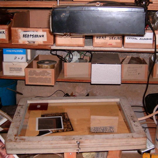

Here is my Simple Setup. Not Fancy, But it Works very well.
This is a Hinged wood frame with a Piece of Soft Foam on the Bottom, under the Glass. Putting the lid down compresses the Artwork between the Glass and the Foam.
Distance between the Sunlamp and the glass is One Foot.
Exposure time is Typically 2 Minutes.
Other lights that are on in the room don't really affect the Exposure as Incandesent bulbs are Low in UV.
